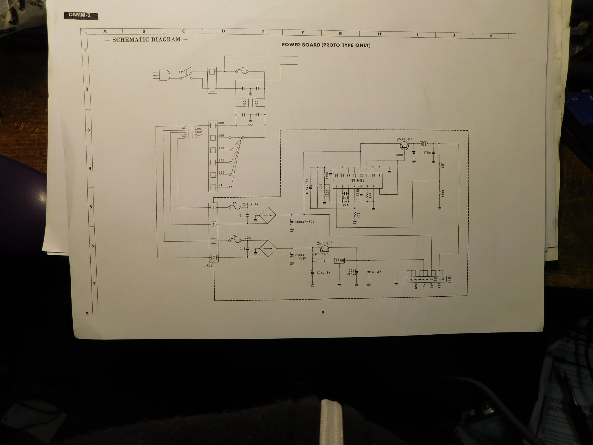

    Hi Robin, I have a Roland PNC-3000 machine, and I am working on trouble shooting some issues with it. Currently, the motor PCB is not receiving the necessary 12V supply voltage. When I supply the 12V using an external supply, the motor can be switched on, but I have been unable to figure out why the motor PCB isn't getting 12V. Another issue I am having is the spindle speed display is not working. Could you please send me a picture of the relevant circuit diagrams? Are the manuals and circuit diagrams available online somewhere?

    This is the PSU, the rest would need some considerable finding and sorting out.
    The spindle speed starts with a reflective sensor looking up at the bottom of the front pulley and connects to the PCB behind the speed control knob and to a rather primitive bar graph on the display panel.
  7. The Following User Says Thank You to Robin Hewitt For This Useful Post:
  8. #57
    Thank you for the PSU schematic that is very helpful! I will start with verifying the PSU is working properly and work from there.
