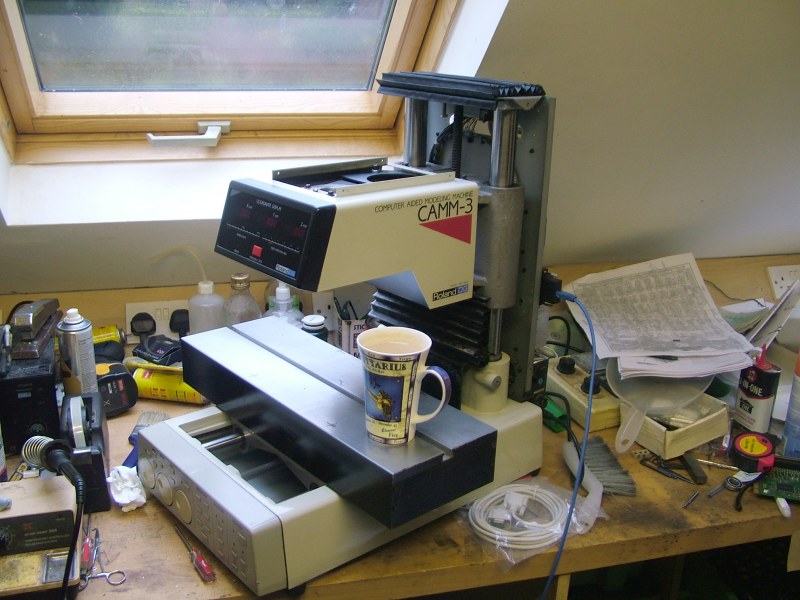

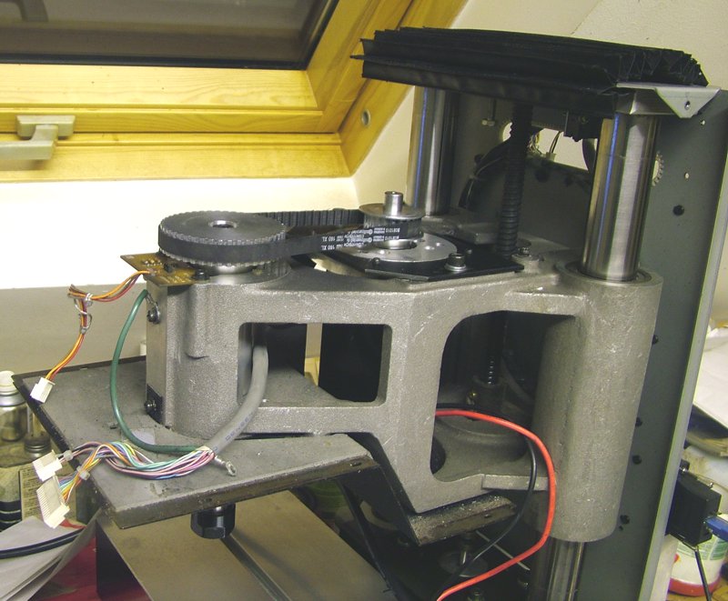

    Mechanically I need splash guards to comply with wifely edict. I also want to hush it up a bit. The brushed AC motor isn't too bad but DC would be quieter and I could slow it down a lot, it's much to fast. I'm fitting an ER16 spindle at the same time because Roland collets leave a bit to be desired.
    Pic 1: Spindle out, motor out, new ER16 spindle waiting to go in.

    Still waiting for bits to do the new spindle. Bought the Ampflow E-150 DC motor and it looks delighful. Slightly concerned about how much heat it can dump into the metalwork without overheating, may need an extra fan. It's rather apart at the moment, you can see the 35mm round rails supporting the head. Feels fairly solid
