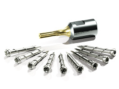

Rotary Broaching is a precision method for producing internal
polygon forms at an extremely fast rate. The entire operation can be completed within seconds and can produce forms to 0.0005" accuracy or better. This advanced engineering has caused Rotary Broaching to become increasingly popular; especially in the medical, automotive, aerospace and plumbing industries.

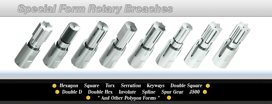

With Rotary Broaching it is possible to broach such forms as:
  • Hexagon
  • Square
  • Torx
  • Serration
  • Keyways
  • Double Square
  • Double D
  • Double Hex
  • Involute
  • Spline
  • Spur Gear
  • J500
  • And Other Polygon Forms
