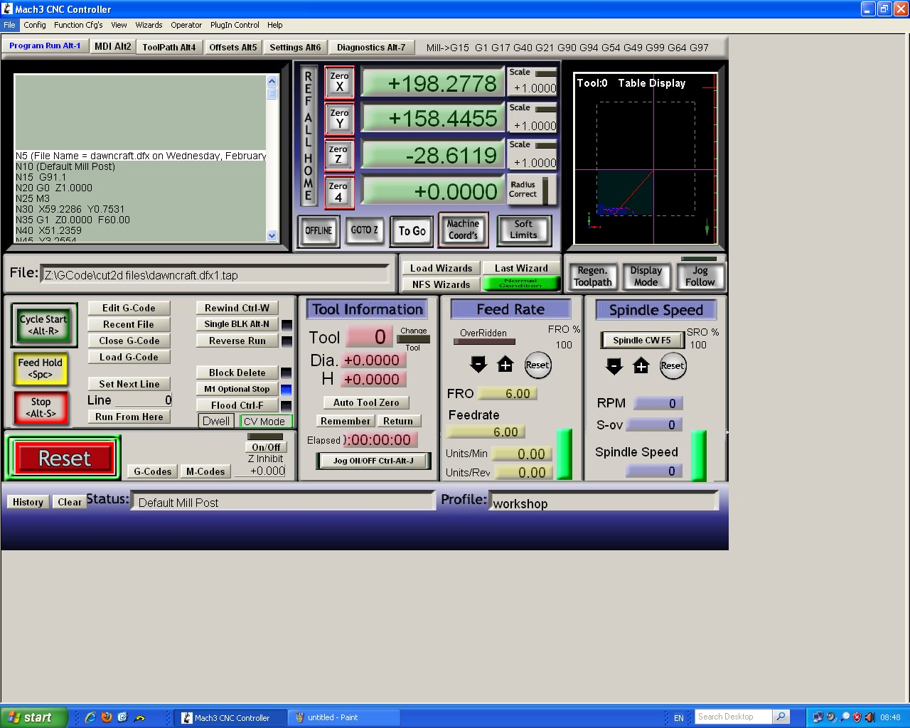

    I have two PC`s one in the house and one in my workshop,
    house one is running W7 and is a AMDx2 4gig ram,
    workshop one running XP Intel 3000, 4 GIG RAM,
    i have put a demo version on both machines and am using Vetric cut2d
    to create the drawings, the problem is my home PC displays all the code
    correctly no problems and simulates the cutting but my workshop PC
    only some of the code and for instance if i have a word i only see one or two letters,
    plus i can not display more than one layer in a 3d cut, can any one help please

    Can I just check that this is a Vectric problem - are you having problems viewing the toolpaths in Mach3 (if that is what you are using) because the Mach3 demo version has a 500 line limit and so only the first few letters of a word would be displayed.

    Hi Gorbo,
    I loaded the dxf file into Autocad and all looked fine. Then loaded it into Vectric and created the toolpaths. As a trial I used a 3mm cutter with 12mm thick material. This created the toolpaths but the gcode file was 3771 lines long. Mach3 demo has a 500 line limit so will only show the first 500 lines, which is the first few letters. This sounds like your problem.
    If so, there are 3 solutions:
    Cut the letters a few at a time by creating toolpaths for groups of letters (say 2 at a time) - check the gcode file length by loading it into a text program
    Pay for the full Mach 3 version
    Draw around the letters in a cad program to try and create much coarser vectors, which will create less gcode - but this is tedious and less smooth
    In Mach3 if you scroll the gcode window down to the bottom is it complete, or does it stop at ~500 lines? Compare it to the same gcode loaded into a text viewer to see if it has been truncated by the demo version.
    I seem to remember Mach3 can run in a simulation mode if the parallel port driver is not installed, which may allow you to view larger files (therefore your home pc might show it all) whereas your garage PC with cutting capability has the driver installed and therefore has the 500 line limit when actually cutting. I might be mistaken on this one, someone might be able to help with the Mach3 arrangement.
    Does this help?
    Thanks all problem solved it was the fact that even they were both demo installs one was not showing all the code due to the 500 line limit, thanks again, now I can cut some stuff
    I should say I have this problem with some gcode produced on other software so its not just a vetric problem, as I said both versions on both PC`s are demo, I will do a screen prtscn of the problem and post it here
