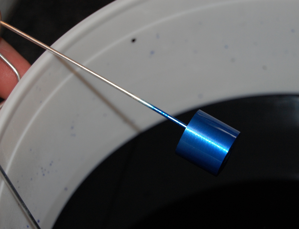

    first step to dyeing it, let it sit in the dye for up to 10mins for a deep colour. (this is just food colour)
    then i steamed it for 10 mins
    this is it after 20 mins of boiling in water to seal it, it did buff up ok.

    i polished just half of this to see how it turned out.
    here's the parts anodised.
    dyed for 10 mins.
    sealed in near boiling distilled water for 20 mins.
    very happy with these test pieces :naughty:
