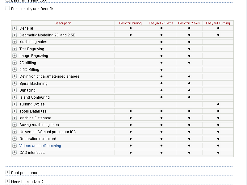

    But EasyMilll cannot compete as it doesn't have the capability to do 4 & 5 axis as can be seen on the picture from their own website It's only 2.5D.
    Phil

    Aahh.... It seems there is another Easymill - the one I was referring to was www.easymill.com (French) or www.easymill.co.uk (English).
    That one does do 4 and 5 axis in 2.5D.
