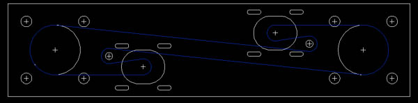

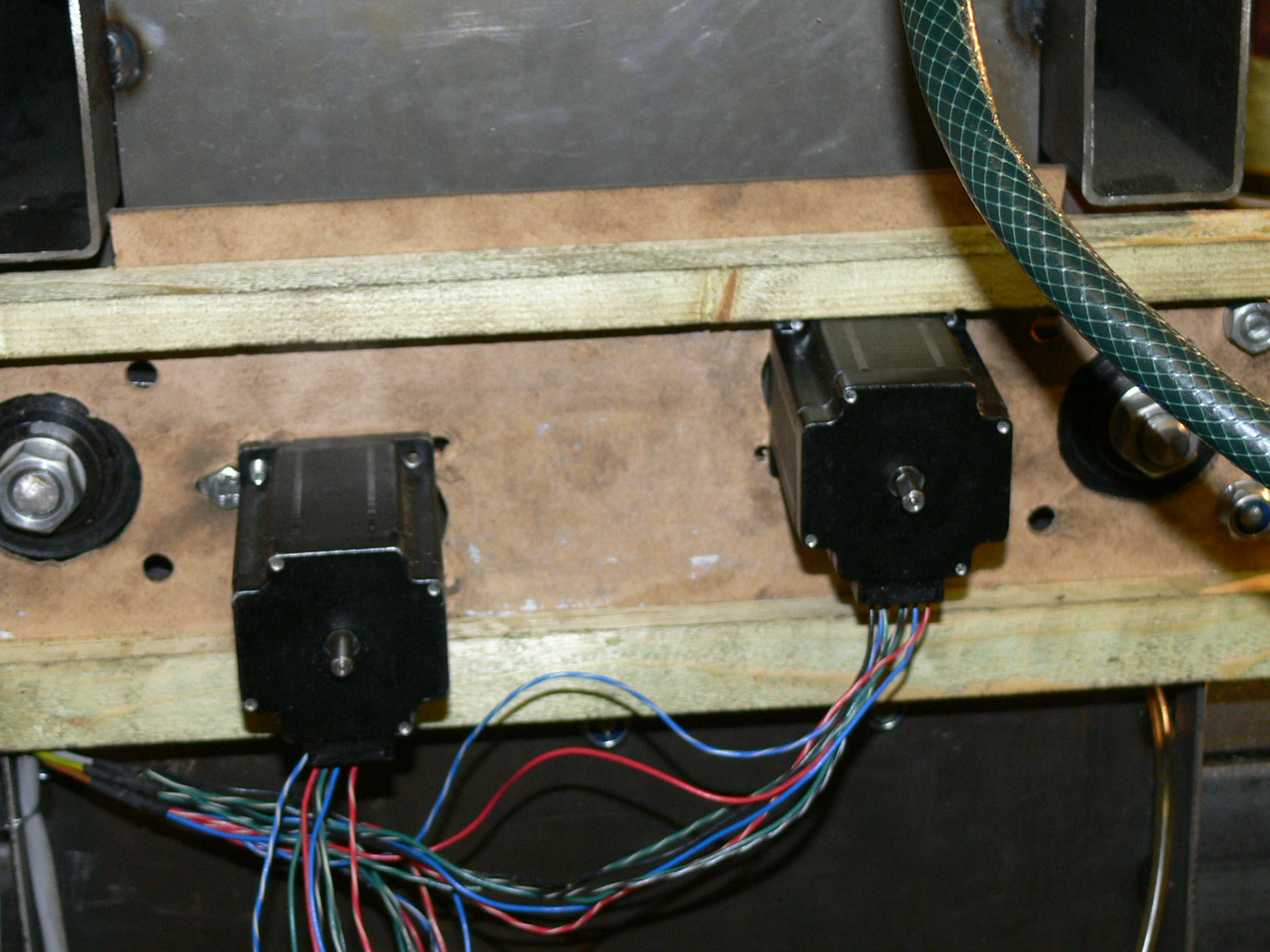

    Just looking at your proposed new drive system, isn't it bad practise to use two motors coupled together?
  6. Quote Originally Posted by m_c View Post
    So far the only problem I had it was when one of the belts snapped and then the other motor was pushing Y car's one side only eventually snapping the second belt or stalling the motor. That's why I decided to use one ,long, strong timing belt. Why do you think there may be any negative aspect of coupling the motors together ?? I've attached mounting plate pic. I'll try to produce it asap.

    Using two motors with one driving each side is ok, but I've seen it mentioned in various places that coupling two motors together can cause problems.

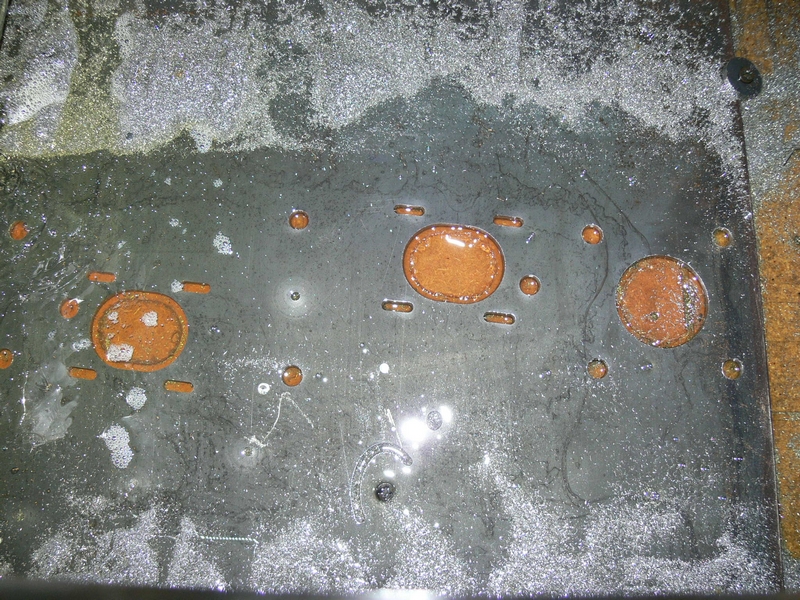

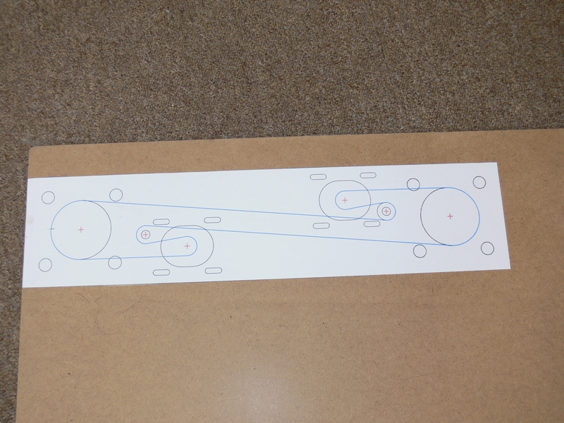

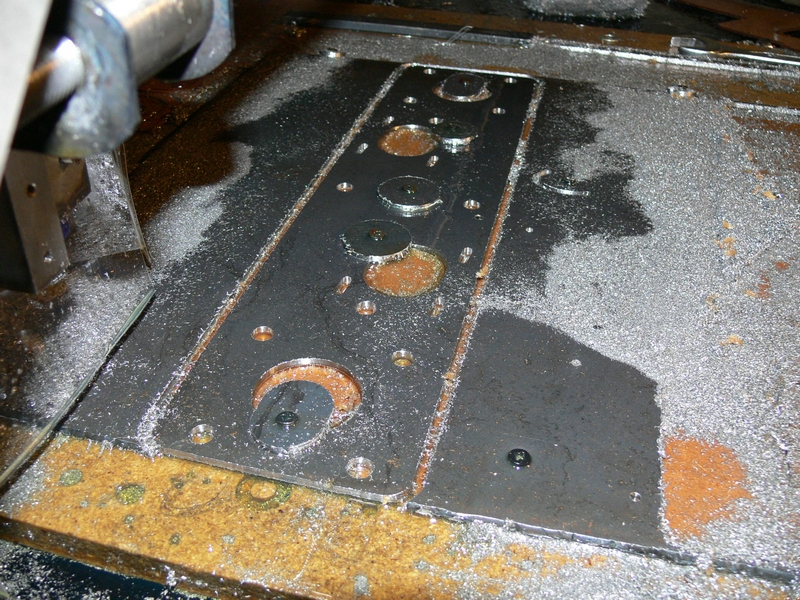

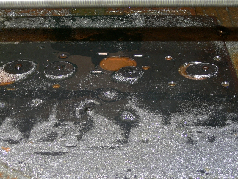

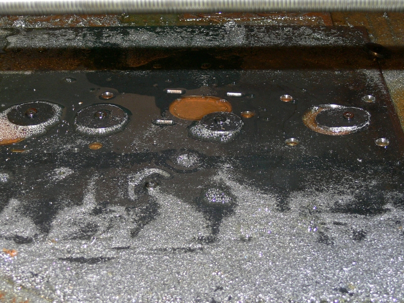

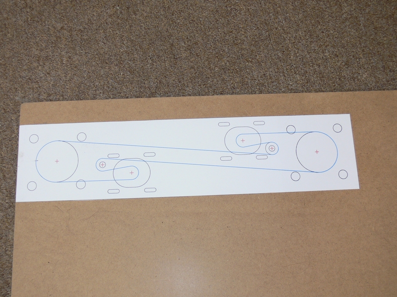

  9. jupi machine alive again :))))
    First in order to cut proper steel motors mounting plate I've made "very sophisticated" 3mm MDF plate.
ID:	3760 Click image for larger version.

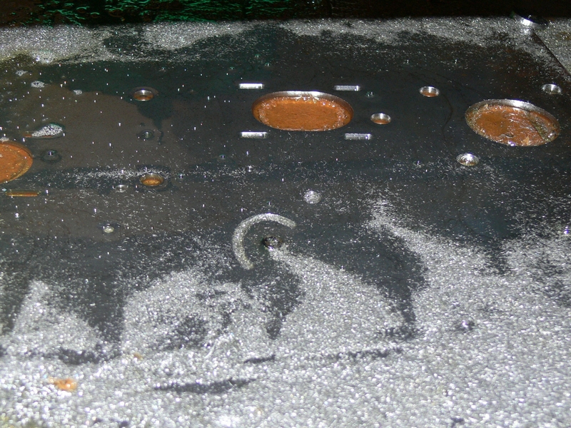

    I've put some corrections and CNC cut from 3mm steel plate, so far insides only.
ID:	3762 Click image for larger version.
    Some inside circle cut-outs are perfect to hold a material while machine cuts outside profile
    Just waiting for end result ;)

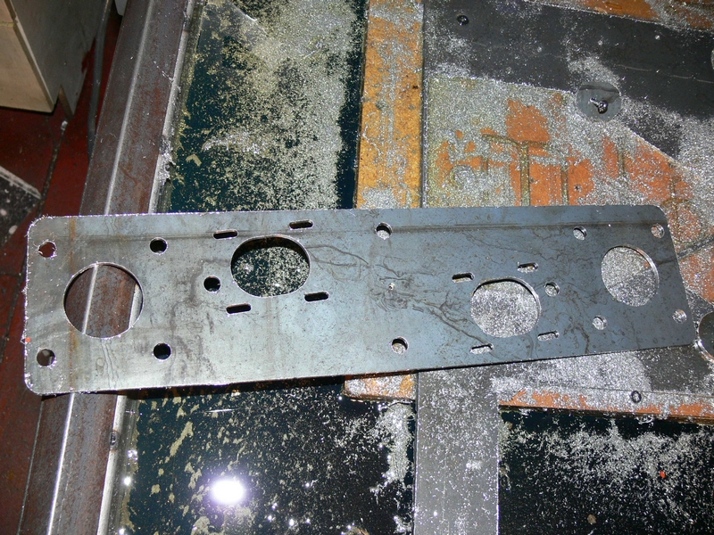

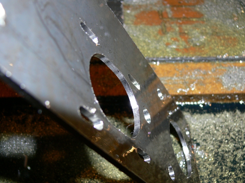

  11. Thanks Chris
    ...and finished item
ID:	3767 Click image for larger version.
ID:	3765 Click image for larger version.
