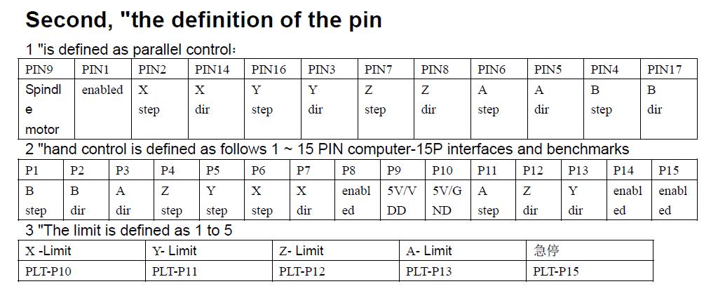

    I have a downloaded document from Zapp for the BOB that has the pin assignments as below. (The document is called "ZP5A-INT axis interface board manual.pdf")

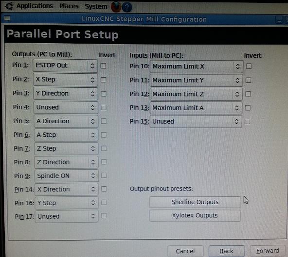

    This is what I have set up on the LinuxCNC.
    I'm unsure of pin 1 (there is no "enabled"), pin 9 (no "spindle motor" - is this the spindle for a router?), pin 4 & 17 (no "B" option - would "B" appear if I set it for a 5 axis board?),
    WRT the second table, is that for use with the "joystick" type manual control - a totally separate connector?

    Are you running two motors on 'X' if you are change 'A' settings to show 'X' (two motors for X running on different pins). Turn all those limit pins off for now, Spindle on is for the relay connection. Section 2 is for separate hand controller you can get for these boards.using four motors still only means a 3 axis machine.
