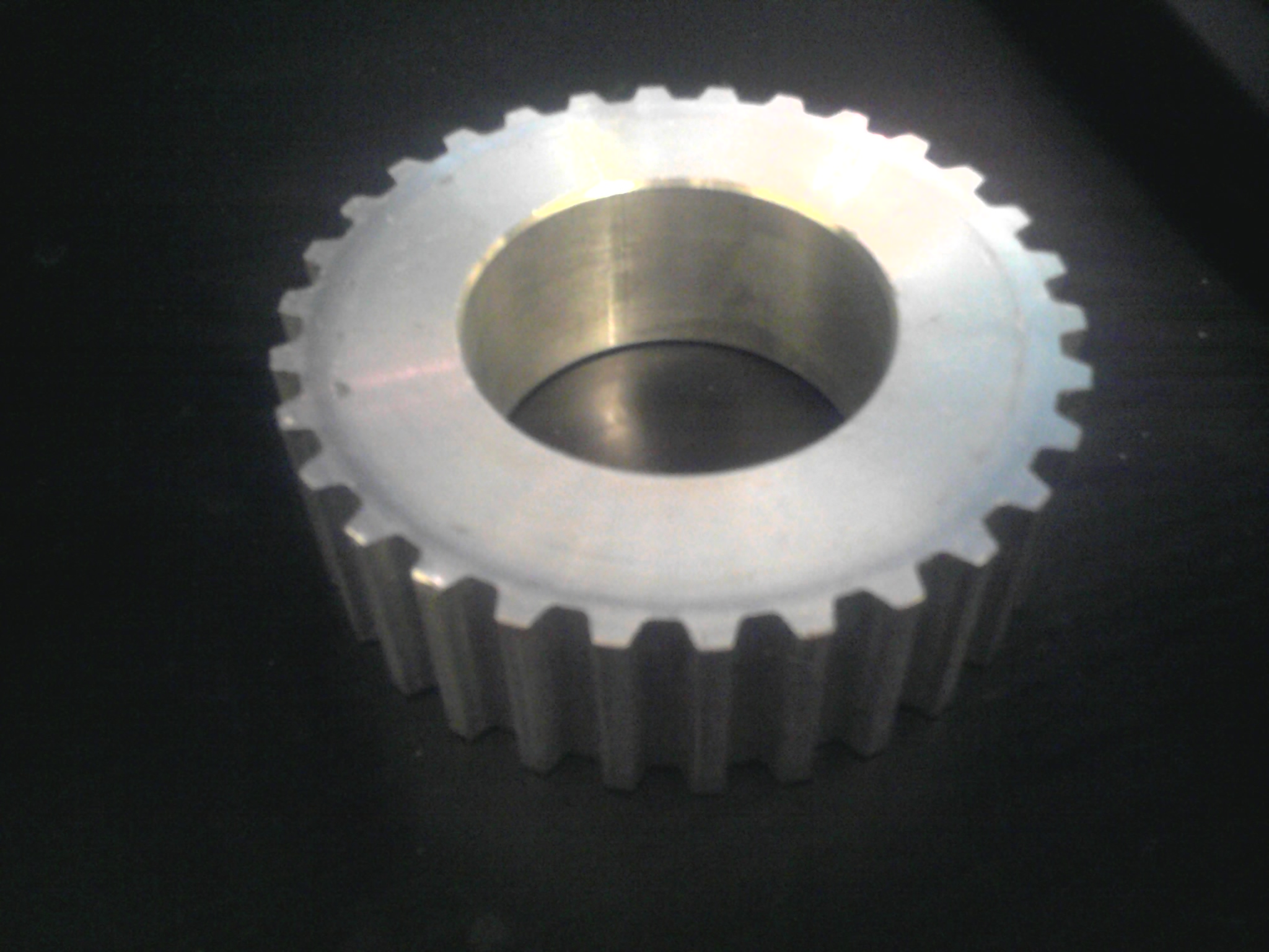

    Hmmmm, they're expensive. Maybe I should buy a dividing head (was gonna get one anyway) and make them myself? Where can I find specifications for such things?
    They certainly are. I used a vertex 6" rotary table and put a stepper motor on it.
    Can cut the pulleys quite quickly if you grind a form tool and hold it in boring head, or just make a quick holder as it's not exactly complicated. I've posted a thread with more about it somewhere, including a program I wrote to mill the pulleys. My pulleys are XL so in the end I just ground a trapezium of the right dimensions on the end of a piece of 5/16" HSS from the lathe.
    5mm Pitch
    Isn't it ironic how I could do with a cnc mill to make the parts for my cnc mill? I know there's a load of timing pulleys dumped in a box at work. Will have a mooch through it when I get time. I certainly need to buy a rotary table or dividing head. Not really sure whether to get the Vertex HV6 rotary table or go the full hog and get the dividing head or just make my own rotary table with a standard industrial gearbox and indexing via a plate with suitably positioned holes.
    I guess timing pulleys could also be made with a home ground broaching tool. First of all, I need to find me a pulley so I can decide the easiest way to copy the profile...
    EDIT: B'jaysus, look what I found in me scrap bag. It's a 30 tooth with OD of 93.5mm and 30mm wide. Bit big though. Bummer. We have lots of them at work. Tooth to tooth is 10mm so I assume it's a 10mm pitch?

    Personally I'd go for the rotary table, as it's a bit cheaper.
    Remember, you'll still need some method of holding the pulley blanks onto whatever you buy.

    Agree on the rotary table as the savings could be spent on a decent chuck and other tooling.
    These don't seem too bad on price: http://www.bearingstation.co.uk/prod...ing_Pulley_5mm
    I'm guessing the 16mm wide belt is about right? 10mm seems a bit narrow. Only thing they don't show is the maximum bore size. Any idea what size pulley I can go down to on a stepper with an 8mm shaft? I'm guessing about a 12 or 14 tooth to have some meat for the grub screws?

    Just ordered T5 pulleys and belts in sizes 14 tooth for the motors, 28 tooth for the X and Y, and 42 tooth for the Z. So I have 2:1 on XY and 3:1 on Z. Went with www.bearingstation.co.uk as they have a "price match guarantee" and were cheaper than the trade prices Brammer and RS give the company I work for.
