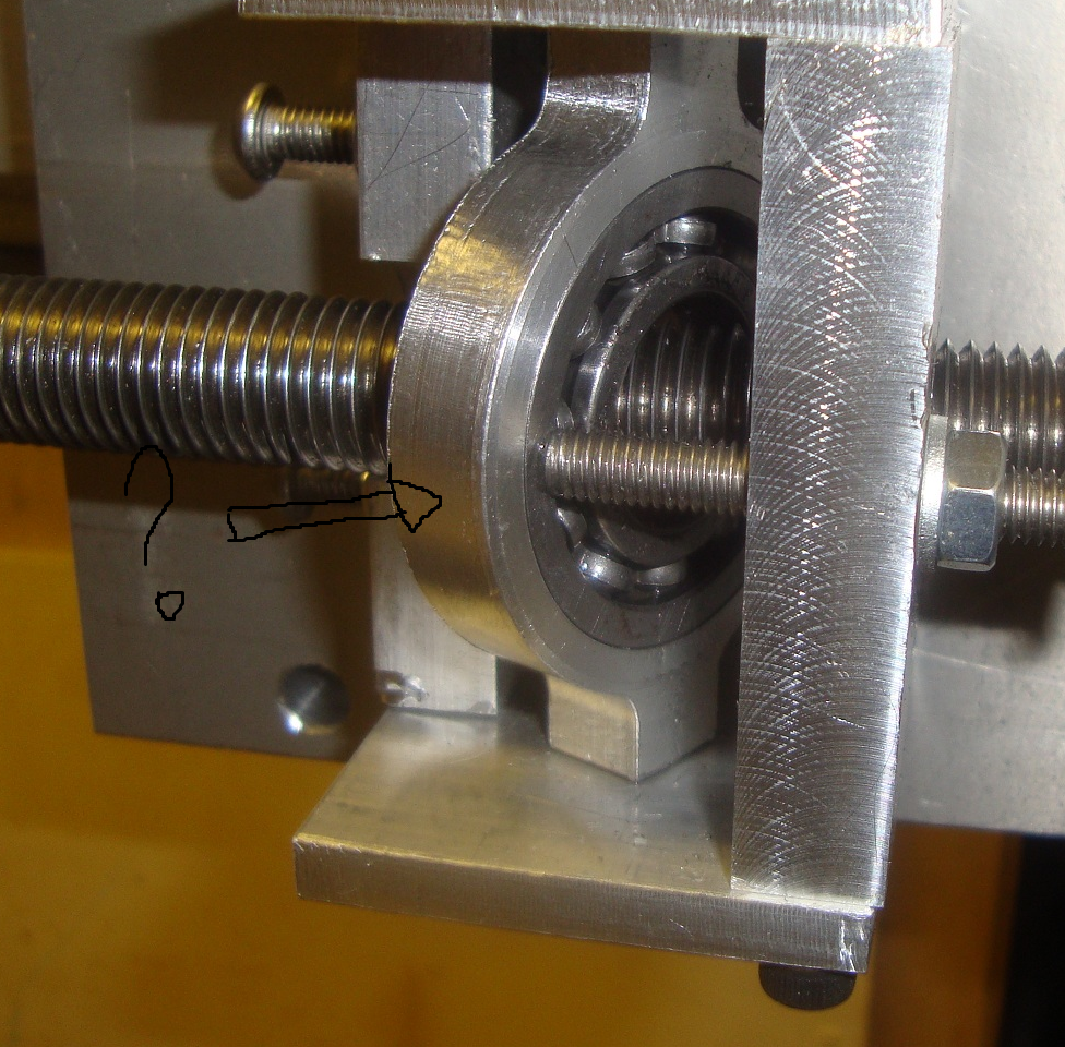

    You have done exactly what I intend to do.
    Except that I was going to use an ACME rod.
    Where did you find this thing on the picture, enclosing the ball bearing?
    Did you get it machined?

    Quote Originally Posted by LabSkis View Post
    I cnc milled it on my machine. I can send you the drawing/Gcode/make another if you like. I made it that slightly odd shape to fit in a tight space on the Z-axis before changing the router design somewhat and using it on Y. If I did another for the Y I would leave more material there for the bolts, and put a spring/belville washers on the bolts so that it rides over imperfection in the screw,
    OK. Thanx for your proposal.
    But I have nothing around here to get this thing machined.
    For the moment, I think I will stick to 0 backlash nuts like the one you find on dumpster cnc.
    Yet, do you think it has a real advantages on those nuts in terms of backlash or friction? Despite the Acme being worn by the roller bearing?
