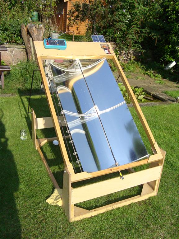

    Nice, I've made all of them too! Probably the main reason I made my CNC router is to do wind turbine blades. Bit off topic, but here's the solar panel (tracking parabolic mirror etc) I made a few years ago:
Name:	DSC02311 (Medium).JPG
    Got any pictures of what you've made?
    Edit: Thought I'd add something on topic. Before I got router cutters I did once have to use a normal milling cutter on plywood - it did make a huge difference.
  4. Quote Originally Posted by Jonathan View Post
    Jonathan, very nice mirror. Does it have sun tracking system ??
    Minnican, yes I want to see some pictures as well :) Very interesting subject
  5. #15
    Quote Originally Posted by wiatroda View Post
    Yes it does - that's what the small PV on the top right powers. There's a small geared motor with a linkage to track the mirror. The mirror rotates on bearings placed around the focal pipe. You can just about see the temperature in that image - that's in Celcius. I've seen about 160C on it. I will post a better picture later when I've found it.
