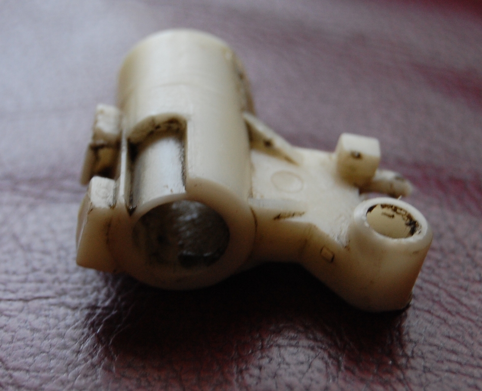

    a friend as asked me to make this for his motor bike.
    i can sort most of it out it's the radius i need help with.

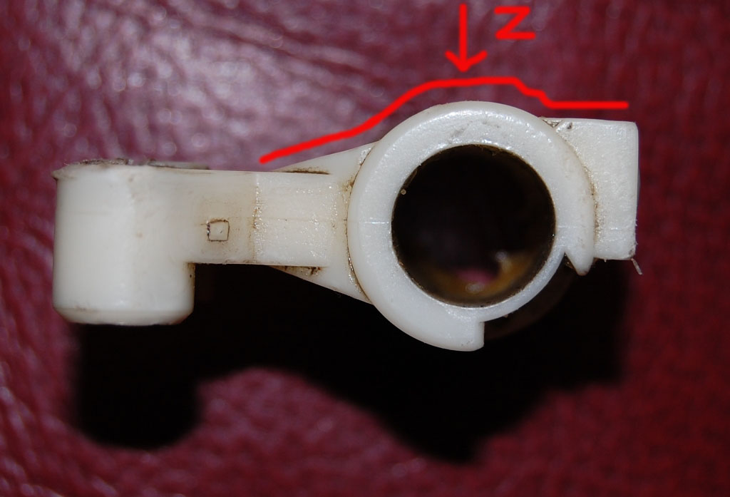

    the red line is the profile that i would like the cutter to follow.
    i am using cambam any help how to get started? i will cut 1 side then flip it and cut the other.
    there is no such thing as a stupid question, just stupid answers !!!!
    Chris
    I don't think cambam can do 3d
    cad.
    You need to model it, I think cambam can do the 3d toolpath though.
    Phil
    Sent from my HTC Desire using Tapatalk
    yo chris.... iv been in a similar position... it'll take weeks to to get a posh sofware package to do some exotic moves for the first time however after that you should have the same kind of job down to a day or two... maybe hours
    still seems a bit of a waste if your not making 20 of the buggars
    with a job like that id omit any non critical profiles and just take care of the luggs holes and recesses in mach wizards etc
    unless your mate isnt in a rush, in which case you could use it as a training exersize and get stuck into some heavy cad/cam packages :)
    ps: let us know how many you scrap :) iv seen your stash of delrin, you can afford it lol
    Good advice on concentrating on the important features rather than trying to make an exact copy.
    For copying shapes in CamBam, in the past, I have scanned (or photographed with a long lens) parts and then traced them in inkscape and exported as a DXF - CamBam will read this directly and you can then create the MOPs to make the cuts. If you have a ruler or known size object in the shot it helps getting the scale right (you can easily adjust the scale in CamBam).

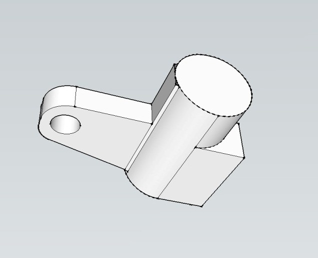

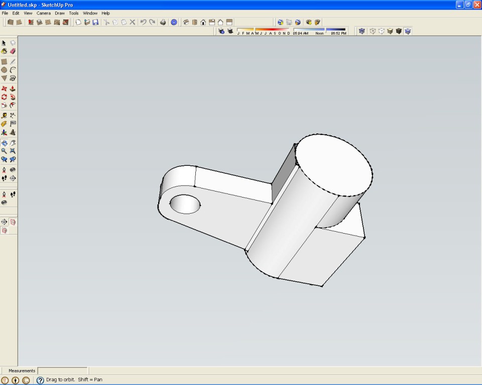

    thanks for the help guys, i am just on with making a modal in sketchup. it wont be an exact copy basically a tube with a lug and holes.
