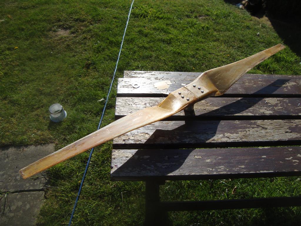

    I've seen those paints in a few shops. I might go for that since though the method suggested above is better, however I intend to use a white gel coat for future blades which won't need that paint. I didn't use a gel coat for this blade due to cost.
    Sadly I've not got an autoclave :heehee:
  5. #15

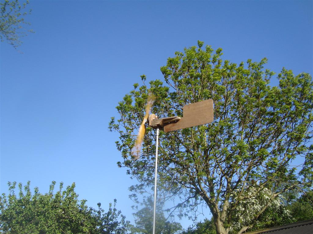

    The blades work! Not that I ever doubted them :heehee:
    The mass of the two blades when I made them was only 2 grams off - complete fluke that. The centre of mass however was quite a bit off. I spent a bit of time balancing them but they're by no means perfect. This caused huge vibrations.
Name:	DSC07309 (Medium).JPG
Name:	DSC07306 (Medium).JPG
    According to the frequency meter the rotor did over 800rpm at times - that means the tips of the blades were doing over 100mph! I need to be careful... next time I'm going to balance them properly and stiffen the tower up. Might have to use guy wires at full height.
    I'll upload a video soon.

  7. Great job Jonathan. Are you going to attach to it some kind of generator? What power output do you expect ??
  8. #18
    Quote Originally Posted by wiatroda View Post
    Thanks... It's already attached to a permanent magnet generator I made. I made the generator about 5 years ago, so I must admit it's not the best of designs! It does produce some power though - peak was 40W into a 12v lead acid battery in that video.
