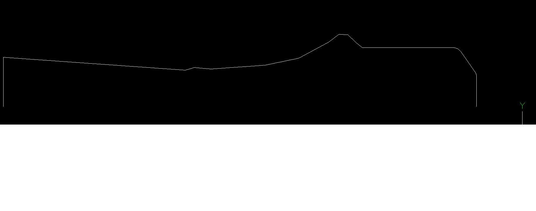

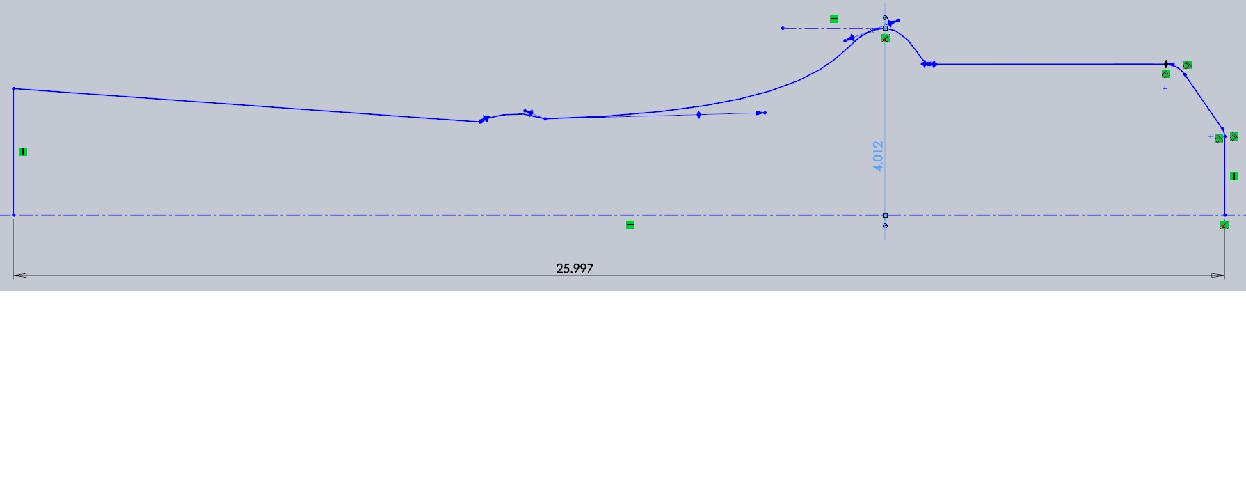

    I have just spent a couple of days on a solidworks drawing (still learning hence the time spent) then saved it as a DXF. I opened it in solidworks DXF viewer and hell it looked so bad. Yet in solidworks it looks good hell it looke great.
    Is there any thing I shoould know about this to prep before the save as ?
    Any thoughts or rambling would be nice folks.

    Below are the pic of the dxf and the screen shot of solidworks.
    There are also the two files in raw state DXF and SLDPRT
    I have previewed this only so not sure how pics will look!

    It does look a bit rough in DFX form, there are only 2 radii on the end that is the blend from the angle to the parallel bit at the front and the little bump further down all the rest are straight lines.
    Have you got a dimensioned drawing i could then draw it for you
    You should set the front face on the Z zero line you have it about 2/5ths down
