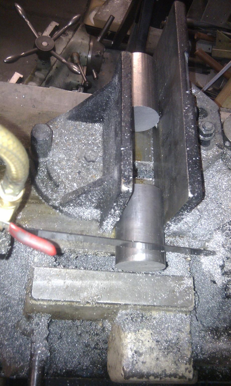

    I thought the bandsaw cut it quite quickly, however over the 50mm distance it was off square by about 5mm which I don't think is very good. I will check the blade tracking and guide to see if that's what caused it. Either way it's a lot quicker than cutting it by hand, though on this occasion I should have just parted it!

    I think the reason you have the taper cut is due to the way you held the bar in the vice, and being to aggressive with the force of the cut.
    You should have a piece the same diameter at the other end of the vice to stop the vice jaws pivoting "See Picture" and a piece of flat bar under the piece to stop it tilting.
    Ok, I'll run it more slowly and put another bit in the other end next time. I've just checked and the bar did not move in the vice at all, it was the blade that wandered.
    I think I should have moved the guard/bearings closer together...it didn't want to budge though.

    You may have the blade tension too slack.
    Try cutting a small piece off a longer bar, you may have had it at an angle without realizing it.
    The blade should break before it wanders that much.
    How slack is too slack? I know that's a difficult one to answer, but is seems fairly stiff at the moment. Would you say it needs to be under more tension than a wood bandsaw?
    Quote Originally Posted by M250cnc View Post
    I must have it too slack then since with it switched off if I lift the saw up and down you can see the blade is pushed to the side significantly.
