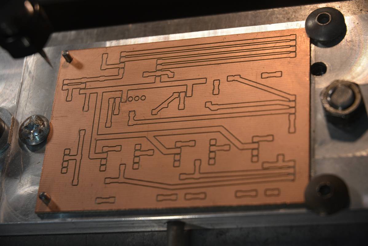

    Quote Originally Posted by wiatroda View Post
    Time to dump good old chemicals, no more classic etching way !!! DIY CNC mill can do it faster and more precise. Small PCB for LM350 adjustable voltage regulator as a power supply for watering system (standard battery power supply with 2xAA doesn't last long, so this time I hope no wife complaining her flowers have died ). Maybe a bit too deep(0.5mm), but it exceed my expectations anyway

    Quite deep, but for 1st cut can not complain.
    May I ask what kind of software was used for circuit design?
    Eagle pcb takes me ages and is inaccurate with leg component distance.

  3. Quote Originally Posted by Tom J View Post
    Tom
    I tried Eagle and did not find it easy, after trying some of the other usual suspects I settled on dipTrace to produce the designs and the FlatCAM to do the isolation routing. Within the last few days I came across copperCAM which looks useful. Here is a link, I have not tried it yet.
    http://www.galaad.net/coppercam-eng.html
    I think that this was my first attempt using that software around 2018/2019 on a Bridgeport mill.

    I made a vacuum chuck to hold it down flat. Measurements showed that it was almost perfectly flat and there was no need for level mapping software to correct the G-code for level.
