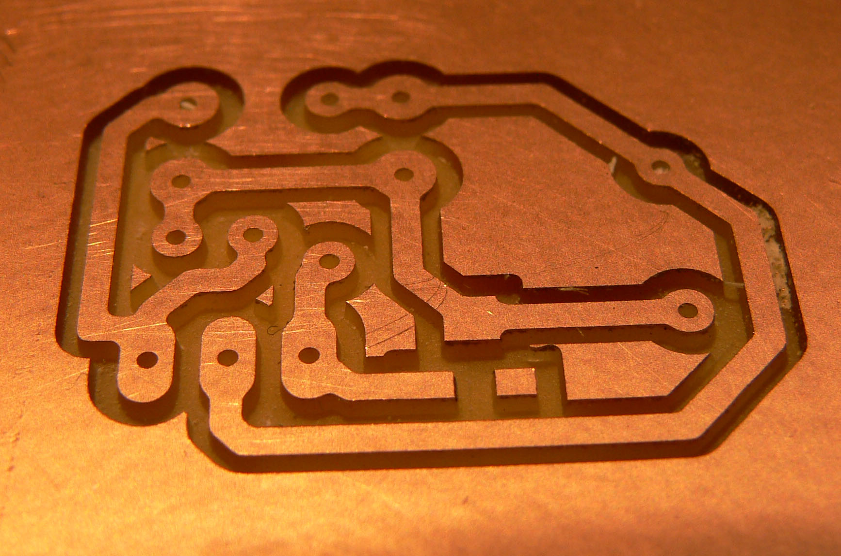

    Time to dump good old chemicals, no more classic etching way !!! DIY CNC mill can do it faster and more precise. Small PCB for LM350 adjustable voltage regulator as a power supply for watering system (standard battery power supply with 2xAA doesn't last long, so this time I hope no wife complaining her flowers have died ). Maybe a bit too deep(0.5mm), but it exceed my expectations anyway

    Quite deep, but for 1st cut can not complain.
    May I ask what kind of software was used for circuit design?
    Eagle pcb takes me ages and is inaccurate with leg component distance.
    Tom

  3. Quote Originally Posted by Tom J View Post
    Tom
    I tried Eagle and did not find it easy, after trying some of the other usual suspects I settled on dipTrace to produce the designs and the FlatCAM to do the isolation routing. Within the last few days I came across copperCAM which looks useful. Here is a link, I have not tried it yet.
    http://www.galaad.net/coppercam-eng.html
    I think that this was my first attempt using that software around 2018/2019 on a Bridgeport mill.
