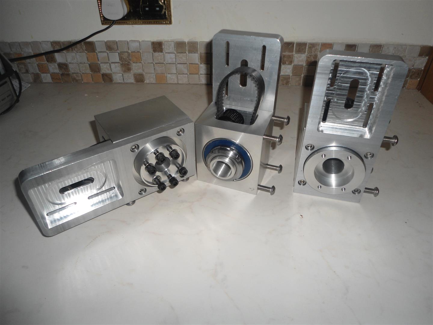

    +answering to 50 emails, 3-4h redrawing for different motors and mounting, 8h to make parts and 2h for 2 people to put them together, 2h packaging, 1h sending . .
    I know the feeling....

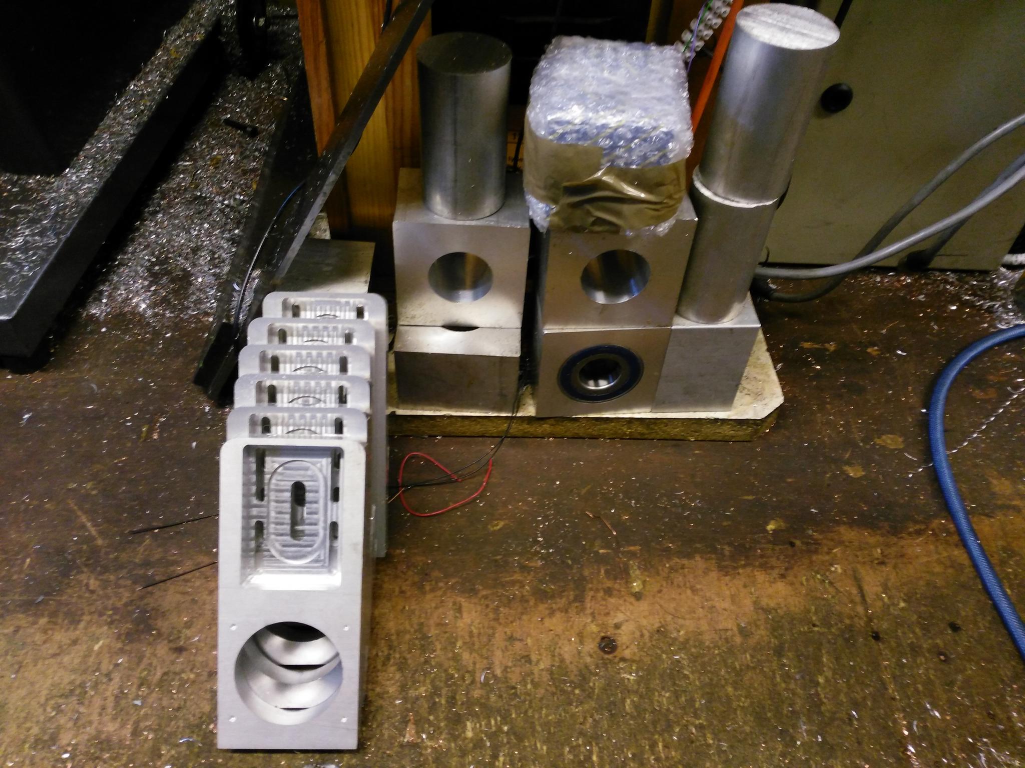

    Having said that, I did start making a few some months ago, but got distracted by another project:
Name:	2016-09-13 11.20.39-2.jpg
    I already have the bearings etc. I'm willing to finish these off and sell them, as I have a bit more time now. Silyavski's price is about right, maybe a little less - fortunately I bought the bearings before the £ crashed!

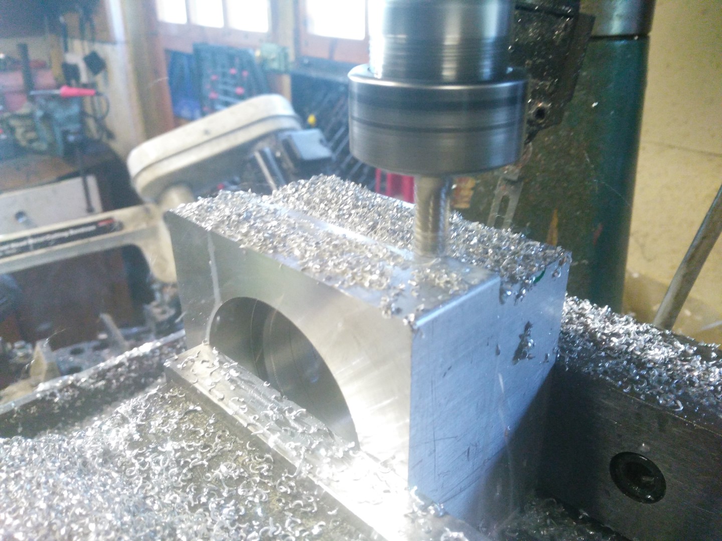

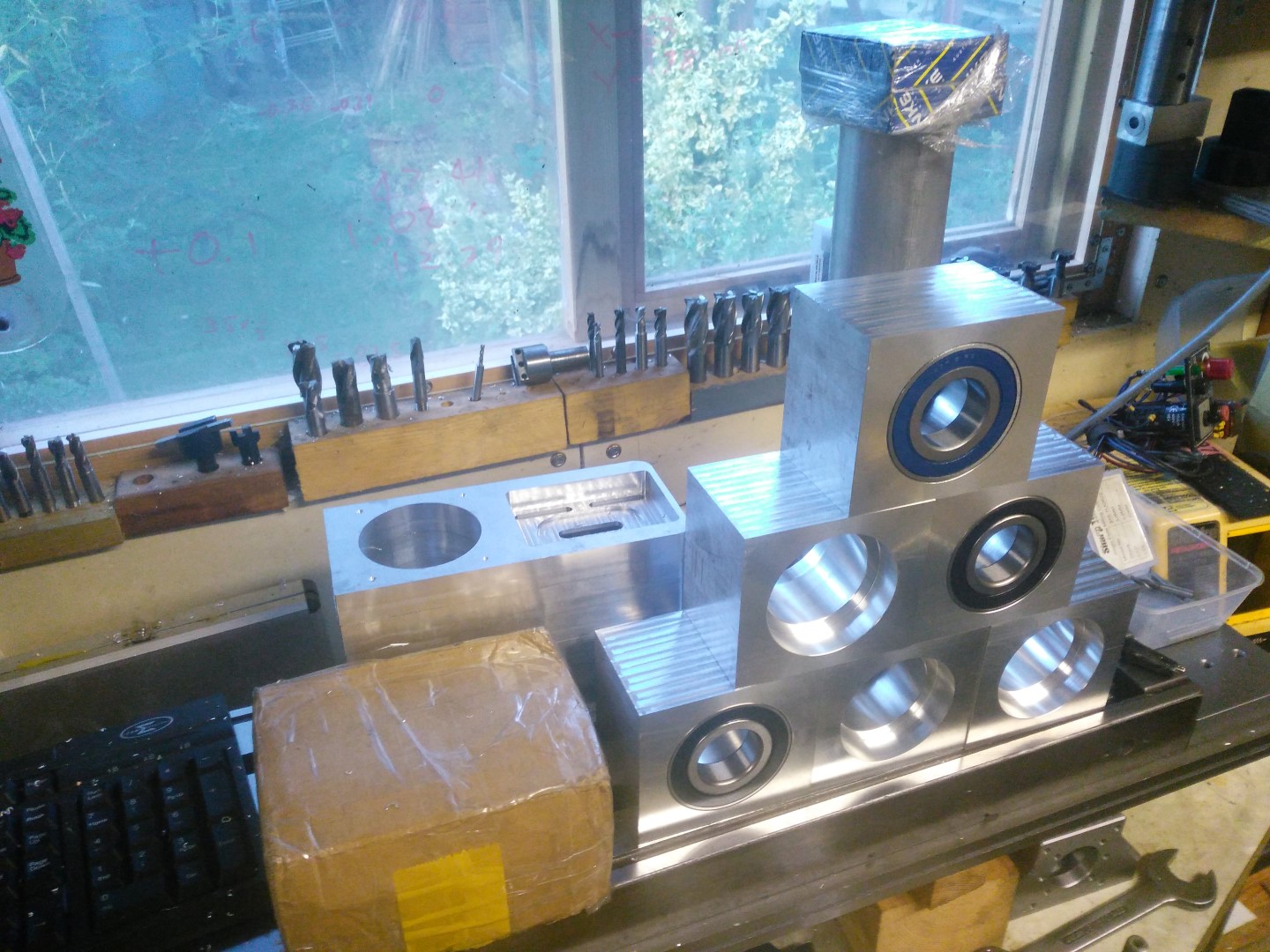

    This weekend, I made some progress on the six mounts I'm making:

    I'm away racing next weekend, but after that I should have time to finish these ... at last.

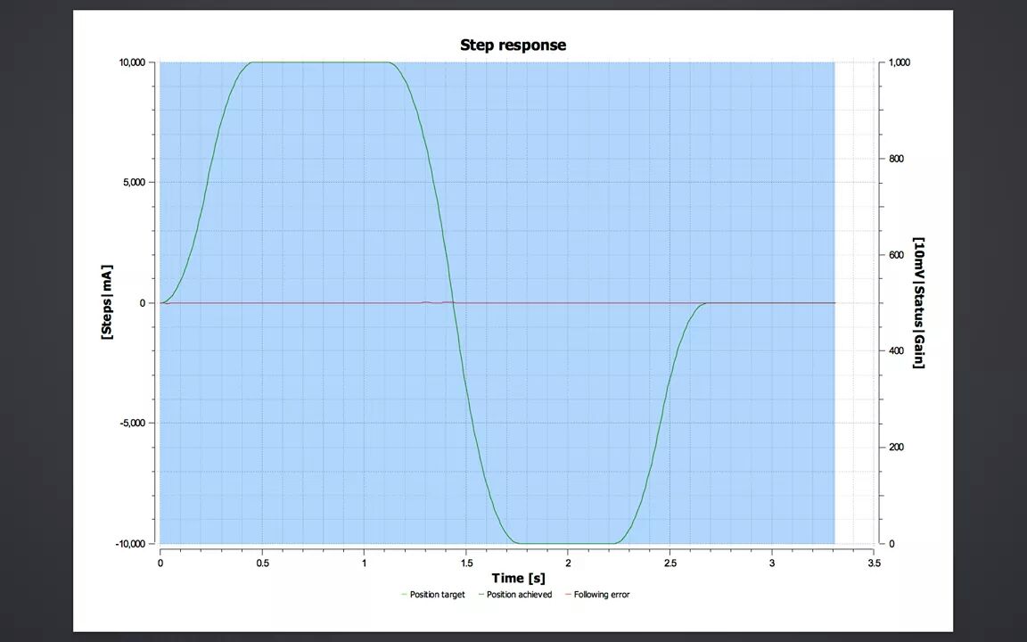

    Hey I have a large router that is running well but I want to upgrade the main screw to a fixed screw rotating nut design. The screw is 40mm dia 10mm pitch and 3m long so its heavy. Running a 940W AC servo and a Grantite Devices VSD-XE servo drive, and 80VDC supply, I'm getting good response now with 8m/min velocity and about 400mm/s/s acceleration. This took a long time for me to work out the servo tuning but I got there in the end. I'd like to remove the rotating mass to improve my accelerations. The gantry it moves weighs around 150KG I estimate.
    So I am wondering are you interested in building me a ball nut for this? Happy to pay market rates of course and if it helps fund any of your emoto projects then all the better. Please contact me if this is interest to you.
    Below is my final servo response I got recently which I am really stoked about it, but to speed up my jobs I really want to up the accelerations.
    With that size ballscrew then you do have a problem with the rotating inertia, not so much the 150kg gantry. Can you measure the ballnut - approximate it as cylinders, then we can work out the inertia of the ballnut compared to the ballscrew to see what you could gain by rotating the nut.
    What else can you plot from your system - can you plot the motor torque in addition to the speed response? If so, that's another way to work out the inertia and get better insight into how the system will behave.

    I'll measure up the ball nut and screw and also try find the original part numbers and specs weights etc.
    The PID loop tuning I struggle with, yes I can measure the currents I think , my Granite Devices VSD-XE servo drives have an inbuilt virtual oscilloscope that I use to measure the response with, to be honest the PID tuning I am very hit and miss with I can;t quite qork out what low pass filters I should use and why.......
    I retuned the PID loops on both x and y on the weekend and its better but still I am sure there is room for significant improvement. whip of the screw is a problem too when I get over 600RPM approx. Thats a 10mm pitch per revolution screw (isthatthe correct terminology?) so thats a speed 6000mm/min , any faster and sometimes it whips and that really gives me the shits. I'm finding that small circle cuts say a 6mm end mill cutting a small 10mm dia helix has some error in the hole and I have to crank the speed back to around 1500mm/min for cutting (the timber) rather than running at higher speeds that I'd like to.

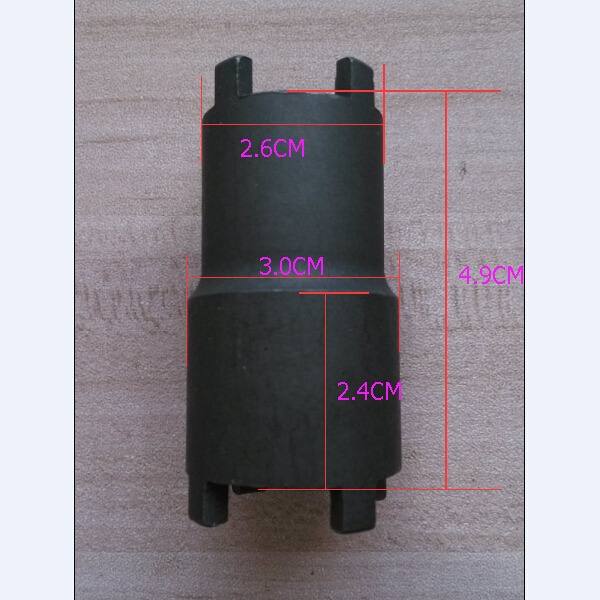

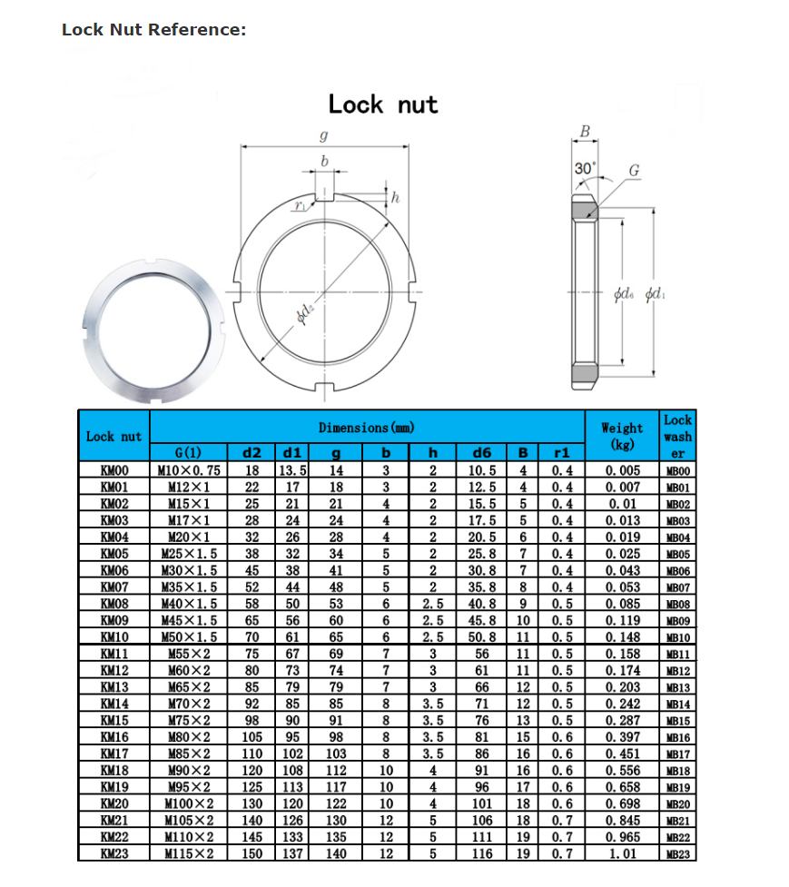

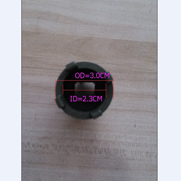

    This cheap tool looks good for the KM03 locknut used if you have 20xx screws and using KM03 locknuts both sides
    Still looking for an inexpensive tool for the KM04 nuts / 25xx screw and KM05/30xx screws. If sb knows , just post it here. Otherwise most probably you have to make yourself one so you could tighten and adjust tension of your ball screws

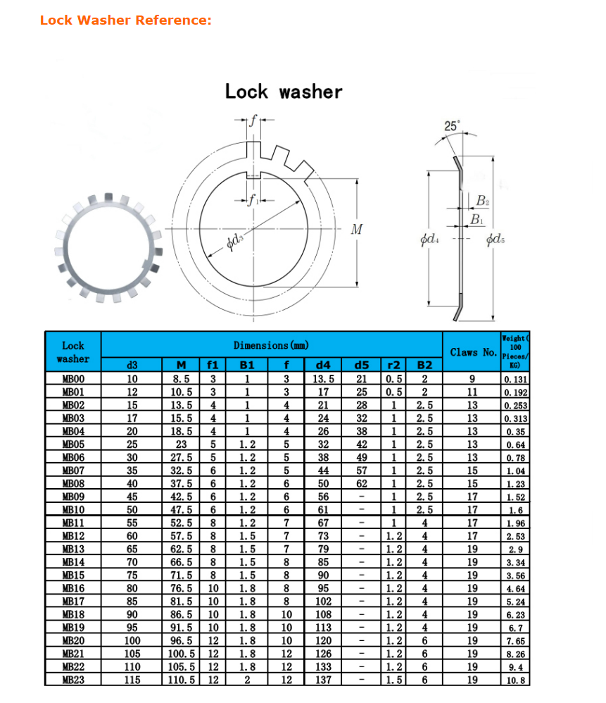

    table of locknuts for reference below, i use 2 each side so total of 4 per screw , locktite on thread, red paint to mark any movement, did not know at the time about washers:
