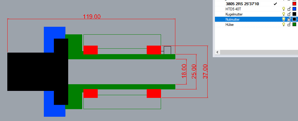

Name:	angetriebene Mutter.jpg
    What do you think of that design for a 16mm ballscrew? Maybe the pulley should go on the right between the bearing and locknut so I can use a smaller pulley.
    The bearings are double row 3805 2RS 25x37x10 spaced 35mm apart.
    It is just a copy of the Fenergy angetriebene Mutter and I will probably buy that one anyways.
    I just extended the spacing of the bearings and didn't copy other stuff that well.
    https://www.google.com/search?q=fene...h=566&biw=1280

    Why do you need a rotating ballnut for a 16xx screw? This should say it all. Did you read anything at all from that thread and the forum?
    project 1 , 2, Dust Shoe ...
  8. #198
    Several times the last 6 or so years.
    Why not? I got a 2m belt on belt drive now and 2m 2005 screws but the 16mm is cheaper and easier to do.

    Just because someone else uses it doesn't mean it's good or should be used, not every one who builds a CNC is good at it or as the experience to know better.!! . . .For instance one of those guys built his machine from wood which says it all really.!
    Also just because a company as designed and sells a product doesn't automaticly make it a good product. I've experienced many products from suppliers like Haase that seem to look good only to find in practise they have some serious flaws, whether that be instantly obvious at time of fitting or appear over time in use.
    With some experience of rotating ballnuts then I see such issues occuring over time with this narrow unbalanced design, but you take your chances and time will tell.
    My point in this post is to say don't be fooled by what your seeing and reading, because most of those singing the praises are the designers and often those that have bought them won't admit they have issues or even have the experience to know they have issues or what the issues are over time.! . .Often blaming other areas of the machine when things do start going wonky.!

    You probably didn't understand the name of the site where the bamboo machine is shown.
    I don't see anything wrong with combining wood with a 3m screw driven nut. The nut is a proven design running in EMS machines for years.
    What's wrong with 16mm screws?
