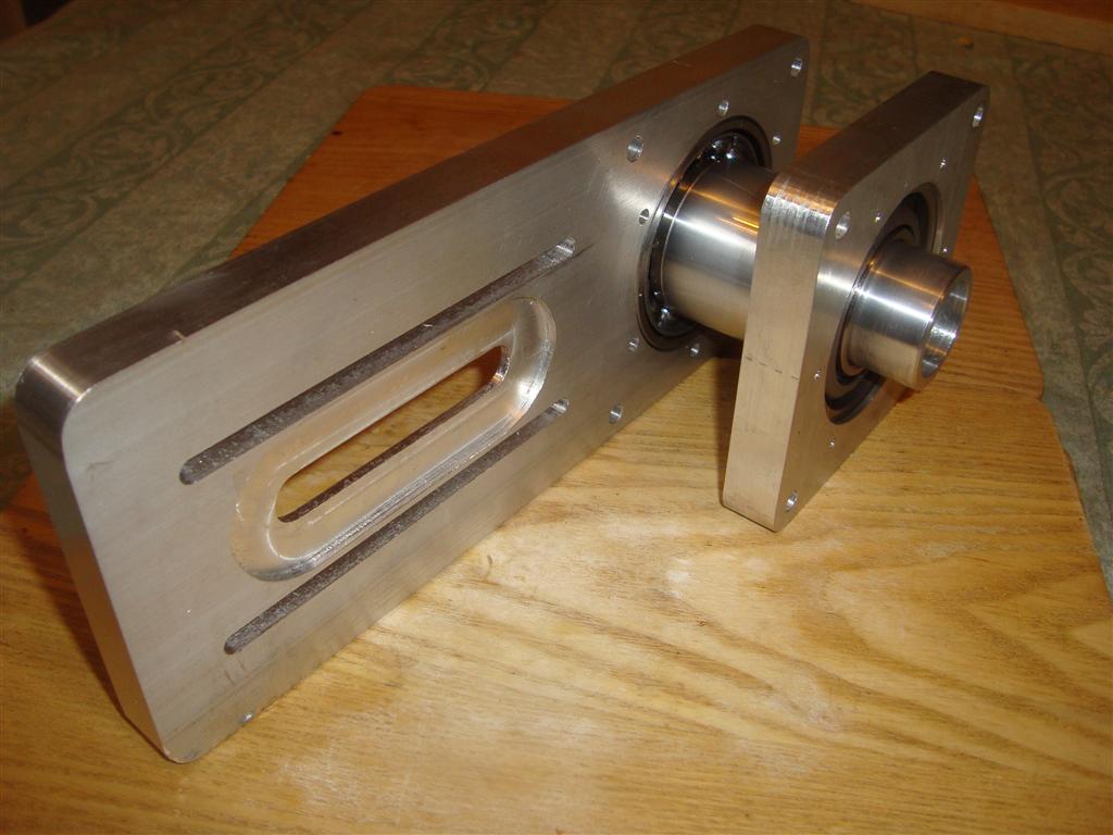

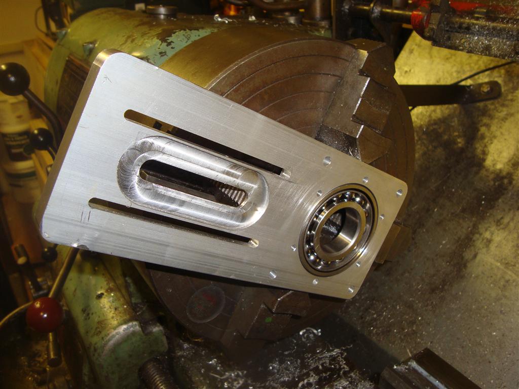

    I have at last started making the rotating ballnut assembly. I've started with one stepper motor mount, it's 100x245mm:
Name:	DSC07800 (Medium).JPG
Name:	DSC07803 (Medium).JPG
    The reason for having such a long cutout for the motor is to allow me to use any reasonable size pulleys without changing the belt, which will obviously be difficult. I CNC milled all except the bearing bore which was bored on the lathe. I had to remove the gap bed on the lathe to do it - the join was painted over so it looks like this might be the first time it was removed! The six holes closest to the bearing will be used to push a ring against the outer ring of the bearing to preload it. The 4 bigger holes are for posts which link this to the other bearing mount.
    I'll make some more bits when I've found my caliper :whistling:

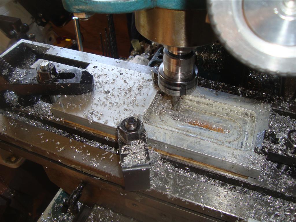

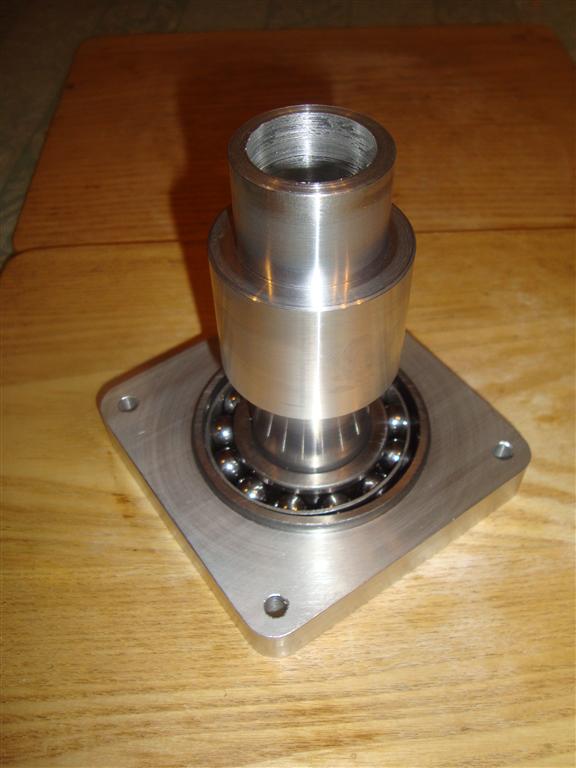

  3. #33
    I've now made all 4 bearing/stepper mounts and one shaft. I will machine the pulley (30 tooth) directly on to the shaft.
    When I machined the shaft on the lathe I got only small pieces of swarf, not the long stringy stuff you normally get - see picture below of drilling it for what I mean. It was almost like cast aluminium...but it's not. Must be a strange grade?
    Lots of photos, hopefully pretty self explanatory:

    It got 0.01mm bigger after drilling...so now 34.99mm which fits the bearing nicely:

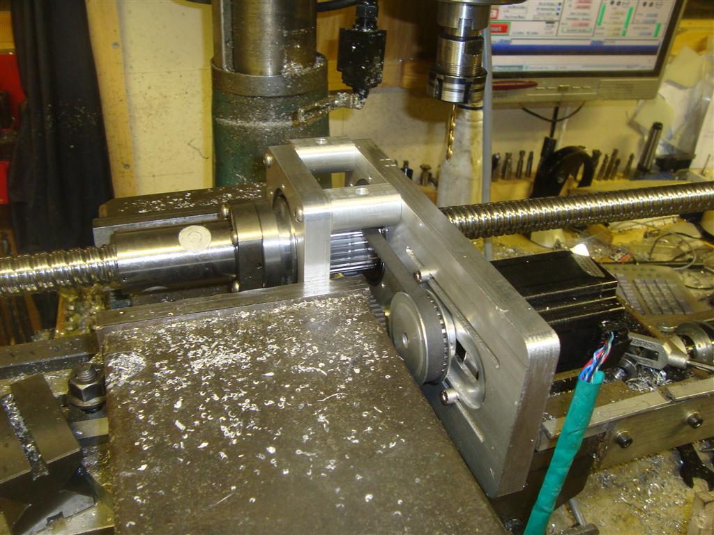

  9. #39
    I have now cut the second pulley, and made the remaining parts for one of the assemblies except the bearing pressure plate. I immediately stuck it in the milling machine vice, put a stepper on and tested it:
Name:	DSC07955 (Medium).JPG
    Will post a video tomorrow. With me just holding the 2092mm ballscrew in one hand it did 14m/min. Almost certainly more - I didn't try.
    Might be while until I finish off the other one since the tip on my parting tool became an Unexpected Flying Object. It might still be ok, but my lathe is buried in so much swarf I can't find it. It took me 5 mins to find the 60mm diameter part I had parted off, let alone a tiny tip...maybe I'll tidy it tomorrow.
