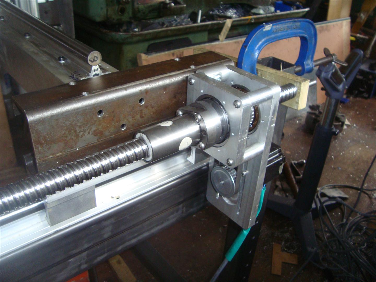

    I just mounted one ballscrew to the frame with a couple of G-clamps and some wood, so not the best but it holds. So with one ballscrew and 3nm motor I'm getting at least 12,000mm/min! It might do more but things are wobbling a bit as I have not fixed the X-axis linear rails down to the frame.
    With the previous rotating nut setup (see post #1) using M20 threaded rod the best it would do reliably was about 2500mm/min.
    The gantry hasn't got the spindle and Y axis screw etc mounted, so it's only about 40kg not 50kg, but still looks very promising. It's odd since for this motor and pulley (28T on motor, 30T on screw) I calculated 7300mm/min.
    Will post a photo in a few mins.

    Video here:
    http://www.youtube.com/watch?v=mSNFD...=youtube_gdata
    Whipping caused it to stall at 15m/min. That be less of a problem when everything is mounted properly.
    Some pictures:
Name:	DSC07964 (Large).JPG
Name:	DSC07962 (Large).JPG
    At 8m/min I couldn't stall it by pushing on the gantry. Above that I
    can, but only by bracing myself against the wall and pushing with both
    hands...otherwise it just pushed me along the floor.
    After the video I tried adjusting the acceleration. It went up to 3m/s^2 quite happily.

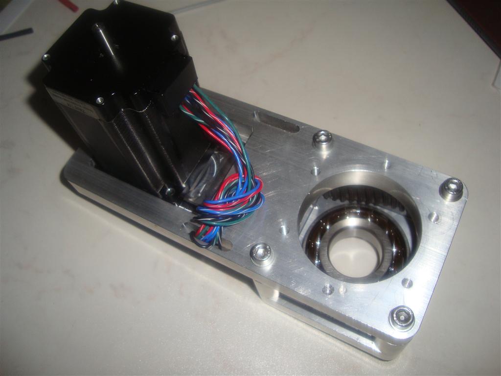

  10. #50
    Update:
    Can't really fault the rotating ballnut mounts. They're rigid and get a plenty high enough feedrate from quite small motors. The oil does keep flying out of the ballnuts, as predicted, so I occasionally put more in and they seem fine.
    I should have incorporated dust covers as swarf does land in them. I did cut some aluminium covers on the router to protect the angular contact bearings:
Name:	DSC08517 (Medium).JPG
Name:	DSC08519 (Medium).JPG
    More recently I have made two more mounts, this time for 20mm or 16mm screws and with polycarbonate covers, HTD pulleys, and just generally neater as I made them on the router which gets a better finish than the milling machine:
