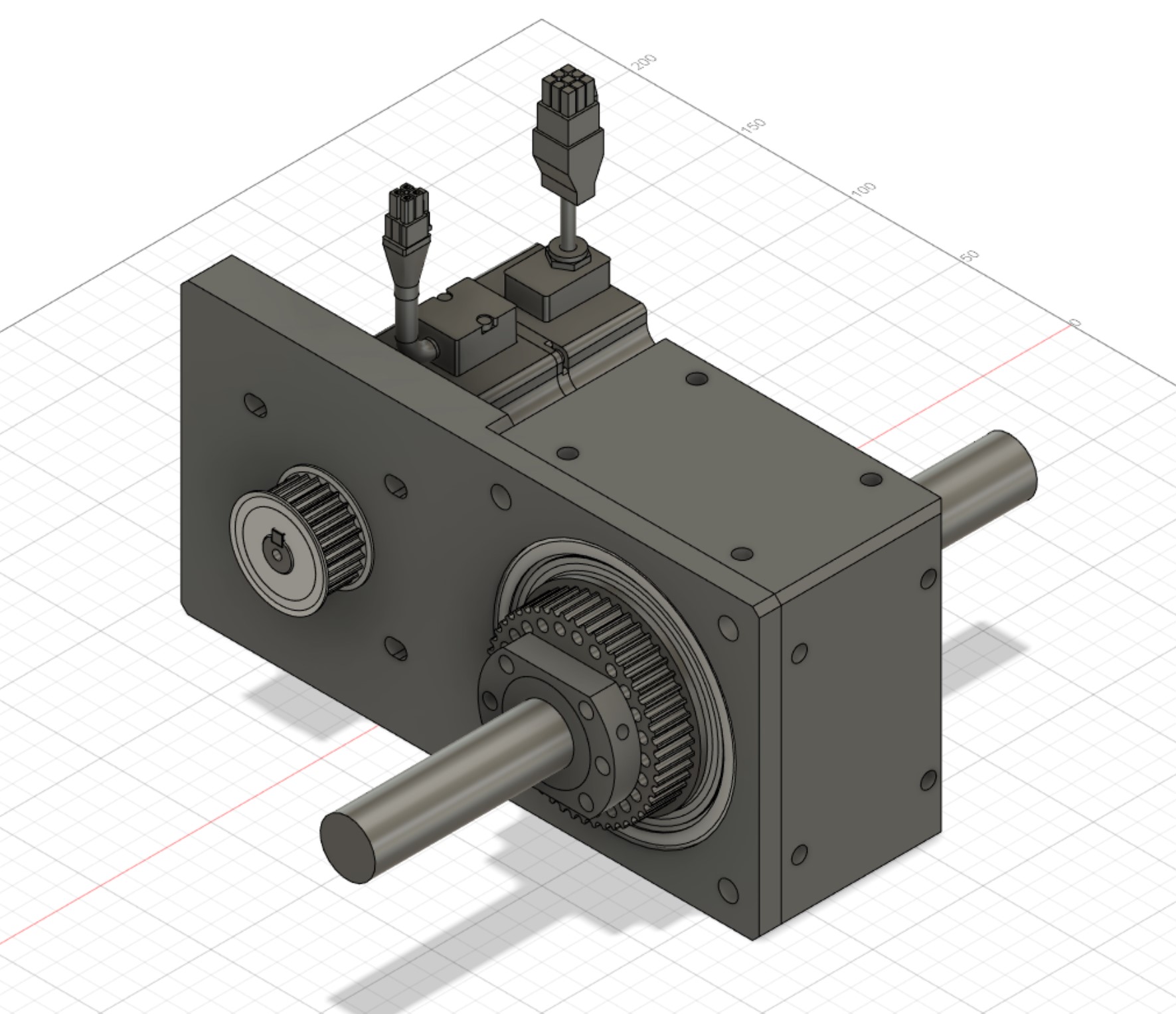

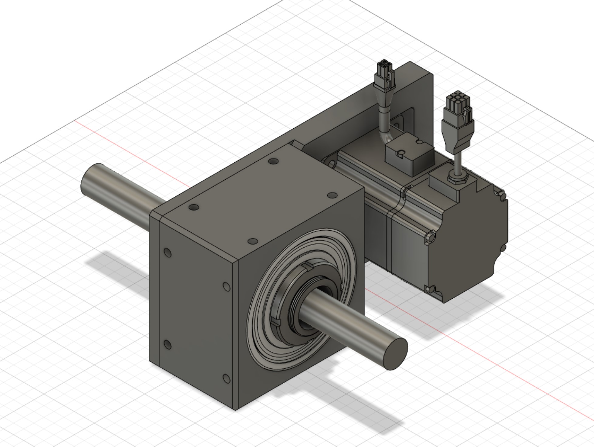

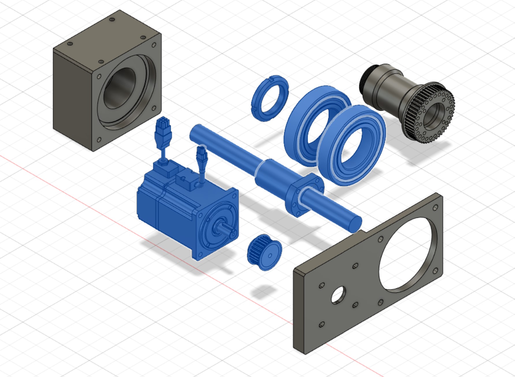

    I tried to match both The Ideas From Jonathan Design and Haase "German Designer" Into One Design, The Ball Screw 2510 with SNFU nut and 750W Servo,

    Main differences:
    - Both Pulleys Are Now exposed Which make it easier for larger ratios like 2:1 " 50T : 25T
    - The Nut is inside not out side in opposite direction
