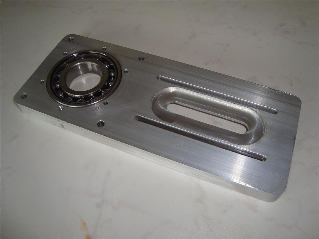

    I will start working on the rotating ballnut mount soon. I'm currently doing one last 3D drawing. I will use 5/8" aluminium for the plates that hold the bearings with some aluminium 'posts' to hold the plates together parallel at a fixed distance.
    I made a mistake with the bearings and bought open not shielded so I'm going to have to put some sort of enclosure round them. I got them on eBay, one SKF and three SBC 7207.
