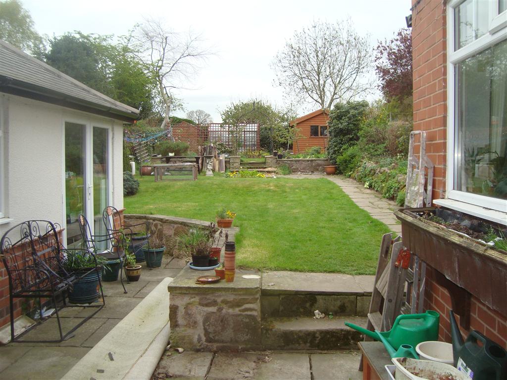

    I've just measured the step, it's only 400mm, patio at the top and bottom.
    The lathe is a Colchester student, Mk "1.5" induction hardened bed...

    This is what we've got to negotiate:

  6. #16
    Jonathan your scenario is a lot harder than mine mine was a straight path, my path is more substantial than yours looks.
    Taking the stand off will reduce the weight but i guess if you stripped every thing off you will only shave off 25% of the weight.
    The lathes are shimmed & mounted to take out twist in the bed this is done by measuring not cutting that is why it is not to be attempted without the right equipment.
    No i haven't done it on a lathe but i did on my small Taiwan mill and they are not in the same class "Junk" is how i would describe them, so no great loss.
    Phil
  7. #17
    Jonathan,
    An engine lift will do nicely to move the lathe. I used a 2 ton lift to get my lathe into my workshop a few weeks ago. I had to cross a gravel area for around 6mts before getting to the stairs of my workshop. I used 40mm thick interlocking flooring boards at 600mm wide by 2400mm long to give a running surface. When I got to the stairs I then spanned then with 6 of 100mm x 100mm fence posts to support the weight. Then the lathe was lifted around 400mm high and placed on the posts running up the stairs. Then the lifter was moved inside the workshop and used to pull the lathe further up the ramp to get it in position for a straight lift to go to its final position. This worked very well and just required care and attention as with all lifting procedures. The thing to remember with engine lifters is that they cannot work outside their footprint.

    I think you're worrying too much: just make sure the shims (if any) go back when them came from. Those Master beds are built like a brick outhouse they'll bend the stand before twisting ;) And, if memory serves (ask Tony at lathes.co.uk for chapter and verse), the heads were dowelled after alignment so even removing the head would not be the end of the world.
    In bits, the job looks safely do-able with a low trolley, plenty of wood, and an 'A' frame hoist to get you over the steps.
