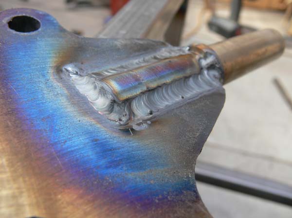

  5. Yes, I agree, it is slower and you need pure argon ( for MIG you can use cheaper CO2). Some sources claim a thermal distortion is lower in case of TIG welding so I assume the heat you put into material is lower as well. The thickest part I TIG welded was 8mm steel plate with 16 mm bar, but it was at the very beginning of my TIG welding adventure with little experience in welding (see pic below) and I'm by no mean I was professional welder.
    It all depends where you're measuring the distortion. As you can see in that photo by the blueing, the amount of heat has been high and has travelled pretty far. The plus side is the weld will be relatively free from thermal stresses, but you end up with a far bigger heat affected zone. With MIG (set so it's short circuit transfer) or ARC, the HAZ wouldn't be anywhere near as big, but the thermal stresses within the weld will be higher. It all depends on what you need from the weld.
