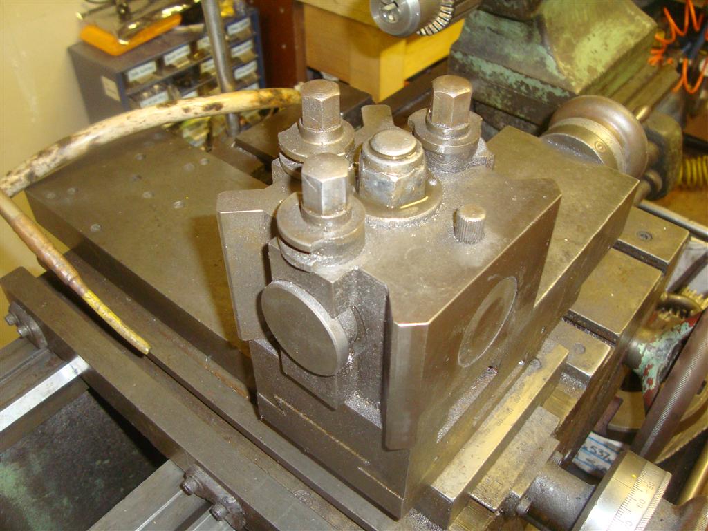

    I'm looking for toolholders to fit the quick change toolpost on my lathe. It didn't come with any! The toolpost is 97x97x72mm, so I think it's a T2 since that's the same as the T2 one here:
    http://www.chronos.ltd.uk/cgi-bin/sh...ml%23aT2S#aT2S
    It looks good, all the surfaces are ground. Quite annoying at the moment I've got the lathe but no way to hold any tools! If it comes to it I'll get one chronos and hope it fits.
    Here's a picture:

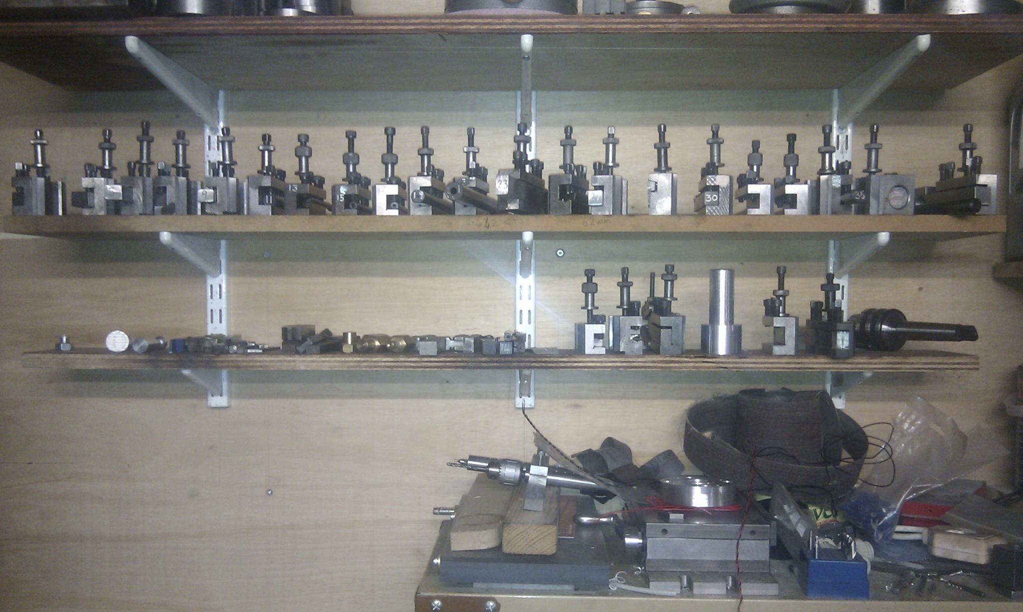

    Little lathe cheap parts, big lathe expensive parts
    I have various holders the next size down from various manufactures from original to new Chronos types
    The newer ones are very flimsy which i only use for small boring tools etc the older beefier types for the bigger tools.
    One thing i can say is hardly any fitted correctly which wasn't an issue when manual turning, but when i went cnc those errors were unacceptable and i had to grind the tool post and all the holders, now changing tools i can hold a tolerance of 0.01mm on diameter.
    The other place is ebay i still want more so i may make my own in the long term.
    Tooling can cost more than the machine, currently i have 26 plus the tools in them + insets = 3 to 4 times the cost of the lathe.
    Phil

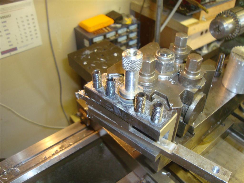

    I got one of the holders from Chronos for £26.95:
Name:	DSC07273 (Medium).JPG
    It seems to fit well and is 'solid'. Even at that price it's going to cost a fair bit to get enough (though not 26!), and it's going to take a long time to make my own.

    Jonathan that toolpost in the picture is 180 degrees out. :confused:

    it is:heehee:
    Quote Originally Posted by M250cnc View Post
    Yes it is, didn't matter for what I was doing though! I realised what I'd done once I'd put the tool in...
