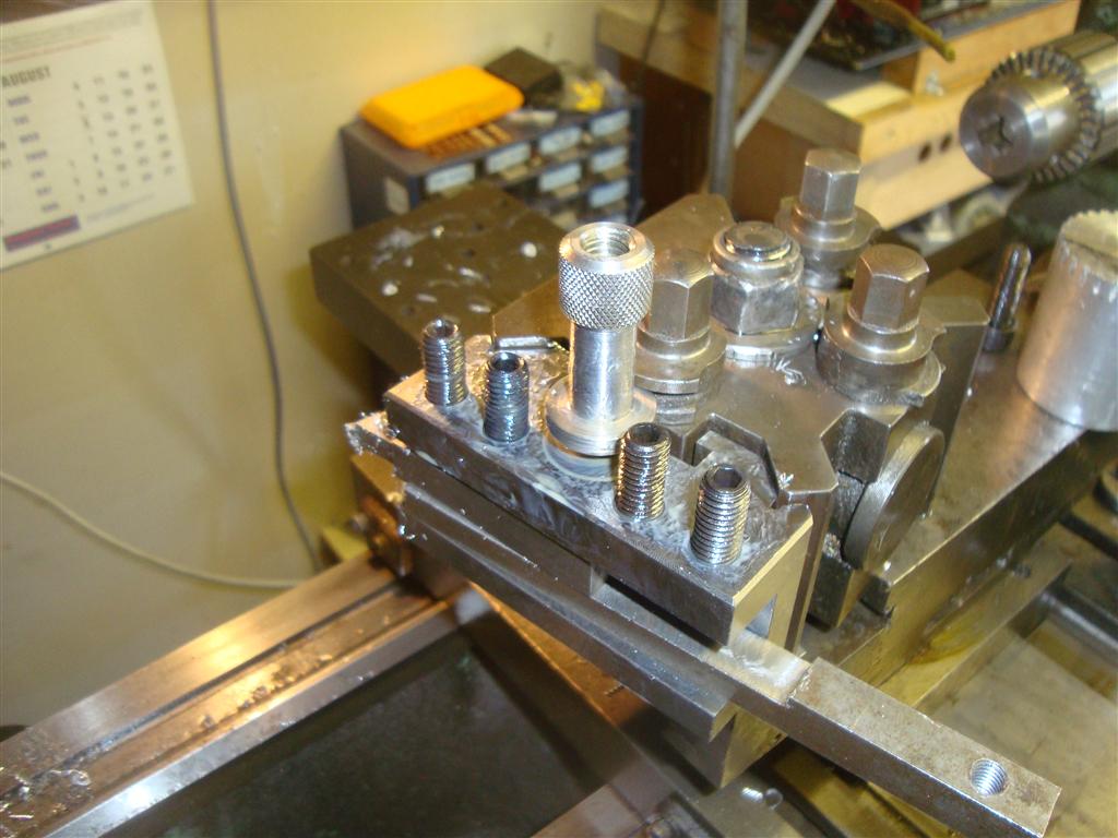

    I got one of the holders from Chronos for £26.95:
Name:	DSC07273 (Medium).JPG
    It seems to fit well and is 'solid'. Even at that price it's going to cost a fair bit to get enough (though not 26!), and it's going to take a long time to make my own.
    There's a version of it here with the proper square bolts:
    http://www.rdgtools.co.uk/acatalog/Q..._Holders_.html
    Slightly more expensive but I might get one and compare.
    Jonathan that toolpost in the picture is 180 degrees out. :confused:
    Yes it is, didn't matter for what I was doing though! I realised what I'd done once I'd put the tool in...
