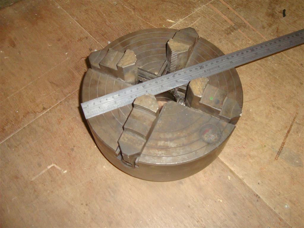

    Quote Originally Posted by M250cnc View Post
    Chuck a piece of quality stock.
    Check with your dti run out, mark the high point on the chuck with a marker pen and note the reading.
    Take out stock then repeat the process and check the readings.
    Thanks, I'll do that tomorrow - getting late!
    Just found this:
    http://cgi.ebay.co.uk/BURNERD-7-5-3-...item2562cafe7d
    Second hand might not be the best of ideas though.
    I've done what you said, with a couple of different bits of stock a few times and yes the high point is always in line with jaw 2.
    I think the jaws that are in there are soft jaws since there are machining marks on them and when I filed off the burrs it felt like mild steel.
    I put the other (definitely soft) jaws in and found that one jaw was in the wrong place. It turns out that I have to mount them in the order 2-3-1 for them to meet at the centre. They seem fine then.

    I dismantled the 3 jaw chuck - there wasn't that much swarf inside. It made no difference to the runout though I didn't really expect it to. I did it so I can try and machine the jaws. The problem is if I machine the jaws it is surely only going to be accurate at the diameter I machine it?

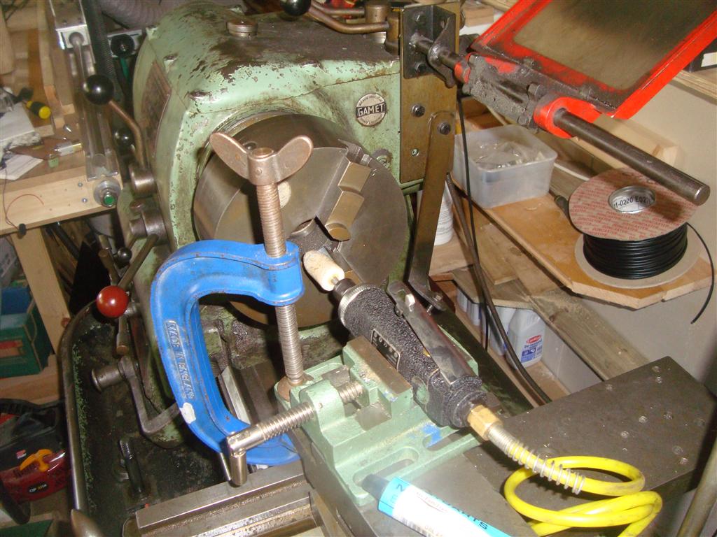

    Dremel mounted on cross slide, will help rescue the existing jaws. Just make sure you clean all the grinding dust back of once you're finished.
    Remember a three jaw chuck isn't good for accurate work. For accuracy you really need to be using a 4 jaw, or collets.
    I've got a die grinder for the air compressor - that should do it. Mounting it is going to be a faff as it's an awkward shape. I'll need to buy a suitable grinding stone for it too.
    Yes, I'm well aware of that. This chuck isn't even close at the moment though. I hope the 4 independant jaw chuck is good. There's less to go wrong with them I think.

    I've reground the chuck jaws using the die grinder. I found a grinding stone that looked fine however the shaft was 1/4" not the 6mm I needed. I put it in the mini lathe with the 4 jaw chuck and carefully turned it down to fit. I used the autofeed on the lathe and took off 1 thou at a time.
    I measured the runout the same as before and got 0.09mm (10mm from chuck) to 0.15mm (@50mm). It was the same with smaller stock too. I've not tried anything bigger than the diameter I ground it at (50mm ish) which might be the problematic one since then the corners of the jaws will be in contact.
    I'm happy with that for now. It's clearly not as good as a new chuck, but good enough for most things. It just means I'll have to use the 4 jaw a little more often.

    This is how I set up to grind the jaws, except with newspaper down to protect the bed:
