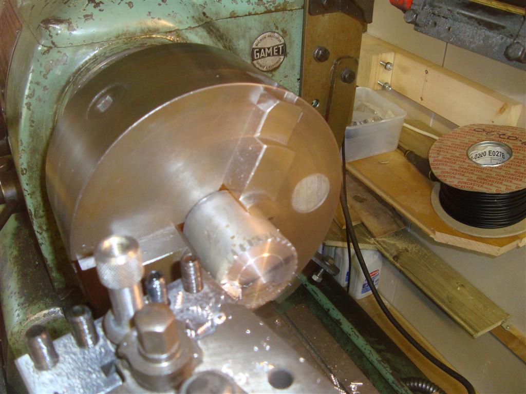

    Watch out for the gamet bearings. If you have to get new ones you may have to dig fairly deep!
    Are they not a standard size then? They seem fine at the moment - if I disengauge the motor and spin the spindle by hand it feels very nice and smooth. Having said that the headstock did get a bit warm near the chuck end when I ran it at 1200rpm for a while. I'm not sure if that's normal.

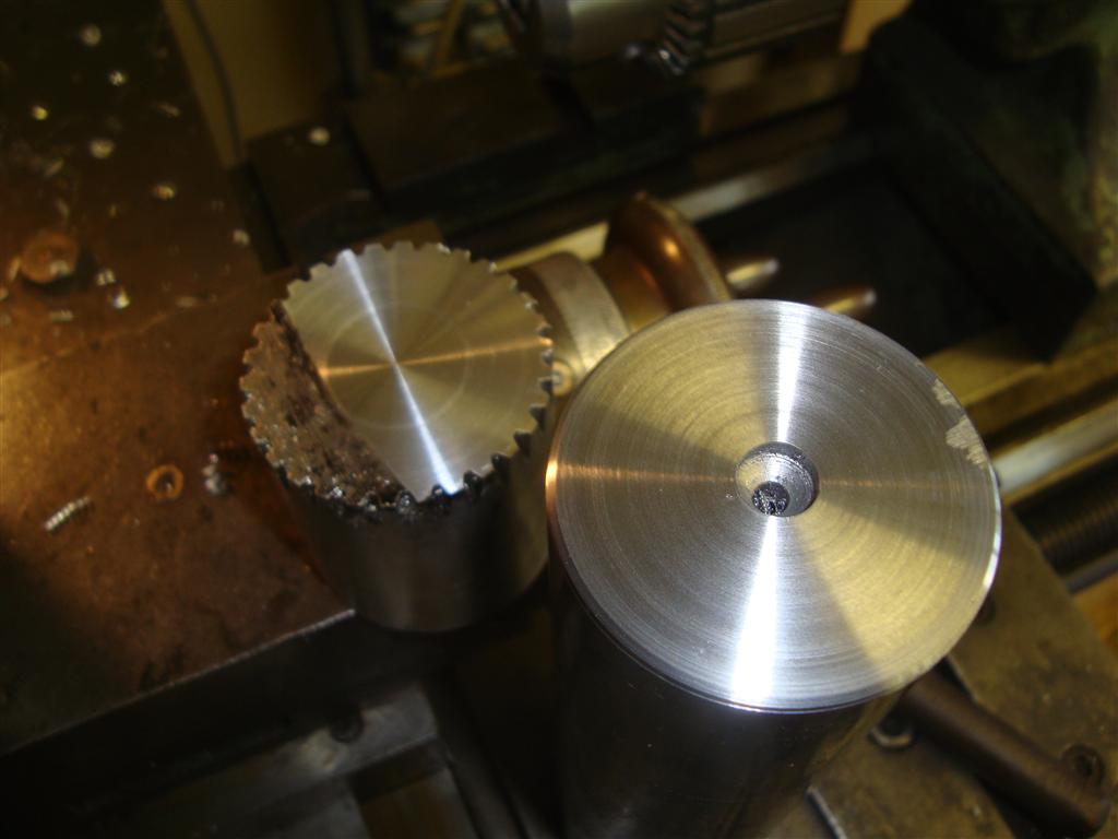

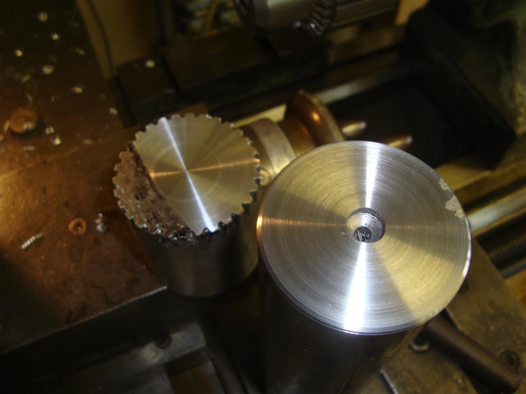

    Just to test I faced 50mm MS & aluminium bar and chamfered the steel, here's the result:
Name:	DSC07270 (Medium).JPG
Name:	DSC07272 (Medium).JPG
    Not the most interesting test but it got a nice shiny finish. Happy!
