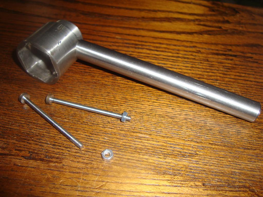

    First useful parts I've made on the lathe:
Name:	DSC07278 (Medium).JPG
    Socket spanner for the toolpost, I made the socket ages ago with the rotary table on milling machine before I converted it to CNC. It happened to fit the toolpost nut
    Second is two small pins for my rc car, 2.8mm diameter - 45mm long. I have not got an MT3-2 adapter so can't use my centres yet so had to do it unsupported. It worked fine though. One of them is stainless steel by accident! They hold the wishbones on - the original is just a simple bar that keeps falling out.
