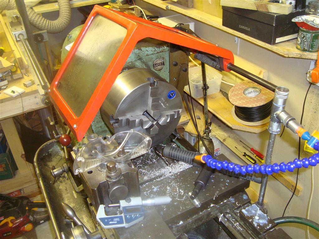

    I've now set up the coolant on the lathe and replaced the old hose thing with the modern flexible hose, so no leaks now, had to make an adapter for it:
Name:	DSC07340 (Medium).JPG
    Also in that photo is the new 4 jaw self centring chuck I got for a good price via eBay. The run-out 100mm from the chuck is 0.04mm approx. That's generally negligible.
