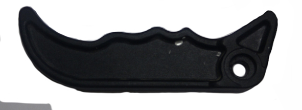

    Hi all Click image for larger version.
ID:	3416This is a trigger from a woodwork clamp.
    It is not so clear but the noes or top right hand bit has broken off.
    It is made of a cast type plastic good smooth outer but honeycombe on the inside.
    So I have been asked if I can make new handles. Yes I can make them but new to cnc so not sure how to get this shape into the Gcode as is needed.
    can anyone offer some good advice please.

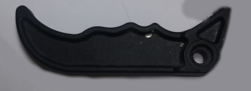

    this is a bigger pic well it was ment to be lol can not seem to get it to the right size.
    Quote Originally Posted by Kai View Post
    You need 3d cad/cam to draw/scan and generate the Gcode. This type of software does not come cheap.
    How many do you want to make ?
    Phil

    around 6 intotal I have the ally sheet to do it with lol its just the chair keyboard interface that is a bit dodgy. I have solid works and solid Cam but dont know how to use them really yet they are so complicated.
    From the photo it looks like it's basically flat with pockets cut out, if so, I'd do it this way...
    Photograph it next to a ruler (make sure you use a longish lens and are square to the object to minimise distortion) or scan it.
    Load the image it into inkscape and trace round it manually - also create a box 1cm long by tracing the ruler.
    Export from inkscape in DXF format and load that into Cambam.
    Clean it up in Cambam (may need to resize using 1cm box as reference), define machining operations and generate the gcode.
    Inkscape is free, Cambam is reasonably priced and you can use it quite a few times before you have to pay for it - should be plenty for this project.
    HTH
    Mark
    Kai
    FatFreddies suggestion involves two more software packages, he didn't look closely enough to see that the inner edges have a radii
    And you will not be able to reproduce those shapes using his method as a rounding over cutter will not go into the sharp corners.
    So the only true way is 3D, it seems you already have the software so you must learn to use it, if you have a funny version it is hard to ask questions without being asked questions if you know what i mean.
    Phil

    The molded shape is not needed just the nose top right and the hole ir the main datum bits the rest as long as it works and is near this shape great.
    Kai if that is the case you could do it the way FatFreddie mentions, but you really need to learn to use what what you already have as that would be best for you in the long run.
    It may be better to ask if there are any solid works users on here that could help you to get the part under-way
    Some software just doesn't work for some people yet others find it easy and vice versa. I dont use solidworks so cant offer any assistance in that respect.
    Phil
    PM Sent
    Phil
    You could use solidworks to trace the part if it can import an image to trace or use inkscape as I described and then import the DXF into solidworks. I've used solidworks in the past and it's a great program but it does take a bit of getting used to. No experience of solidcam I'm afraid.
    Alternatively you could measure it carefully and create the sketch in solidworks from the measurements.
    If I remember correctly, you'll need to create a sketch of the outline and then extrude that to the thickness of the plate. You then create sketches on the face of that part to define the holes / pockets / counterbores and create extruded cuts from those sketches. I'm not sure how solidcam works but in cambam you would then use the outline to create a profile machining operation (MOP) and then the other shapes to create pocket or drill MOPs.
