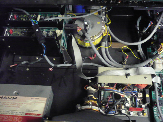

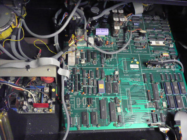

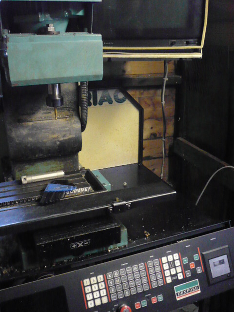

    Hi Guys,
    The strange thing was that while I have pushed the machine hard in the passed and got the spindle motor quite warm, on the occasion it failed it had just finished some light pocketing in ali finished the program and spun down. This made me think it was a motor driver or possibly a relay failure. I'm using the standard Triac software (all manually G coded).
    As i'm not sure which model or year the machine is, i've uploaded some photos for identification.
    Thanks,
    Sam

    i2i's Avatar
    unfortunately there's not a lot of info available for this early version. Check the fuses on the back panel as there may be a seperate fuse for the spindle. Check the fuse on the spindle inverter (rear left), it may be that the inverter has failed.
    Thanks for the tips, I've checked the 3 fuses I can see on the main board, and two more in plastic screw cases towards the back of the machine on the left. They all look ok, are there any others I might have missed?
