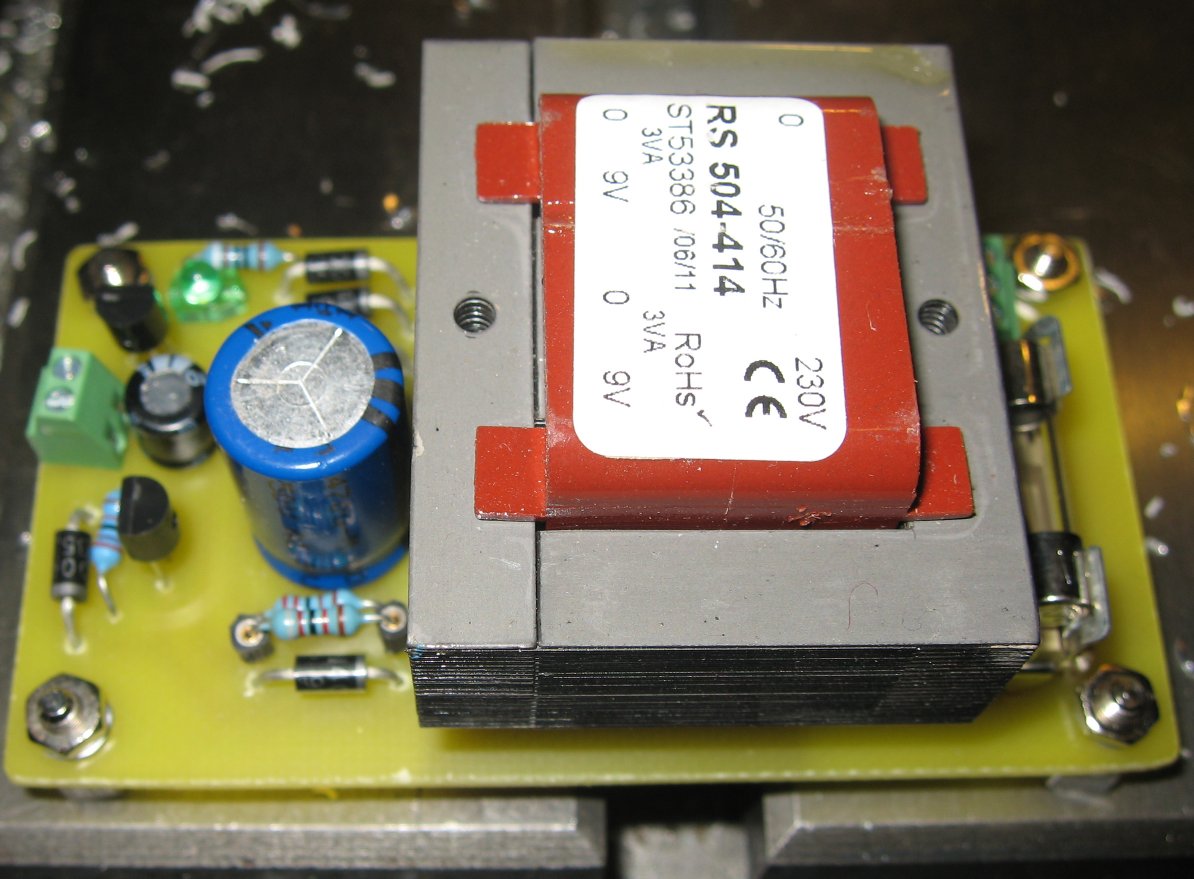

    Thanks for the replies guys, I think I have enough information to proceed.
    I've built the circuit shown in the link from ecat. This circuit works well but I had to change the value of R1 from 27K to around 80K to get a 100ms delay on my relay.
