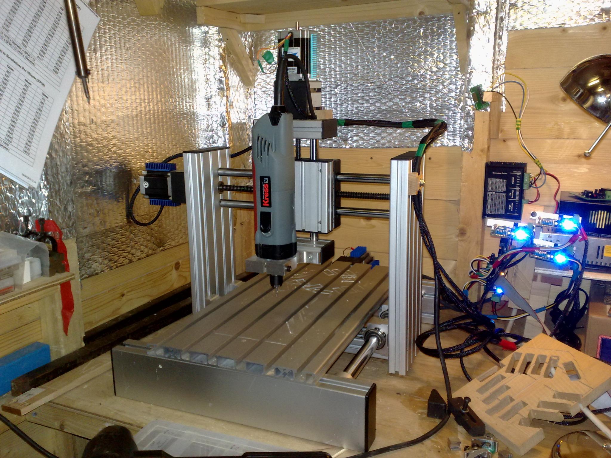

  1. The Router I am running is:
    Marchant Dice MDL-2-TR model which has a cutting area (mm) of Y=250, X=220 (gantry), Z=50.
    The original set up had the the Z mounted on the side towards the Y motor mount and I found that limited travel even further than the above measure. So I changed the position of the Z which allowed all the weight to be more central as well as the slight increase in cutting area. The only down side is that I had to go into Mach3 and inverse the X axis travel set up. It was not a big problem.
    I am currently running Motion King 23HS8603 Nema23 motors that are 1.4Nm. Looking to upgrade to 1.8Nm so that can move a bit faster.
    Using a Kress 1050 FME router for the spindle and it cuts fine though looking at the quick change options being offered by a few different folks.
    I am using DIYCNC boards which are the PCPPS-3 and the older DVR25 driver boards working wonderful and looking to at ways to slave the spindle to Mach3 (Suggestions and directions welcome on this one).
    As stated using Mach3 to control the mess and it works wonderfully. Right now using soft limits and looking at which way i want to mount the limit switches I have to get that bit of added security in the system.
    Using Sorotec milling bits and Dremel routing bits. Both are working wonderfully to spec and getting a very good life span out of them.

  2. Well let's see,
    New Nema 23's from Zap has speed up to 1200mm/min with no problems (anything above 1400mm/min and have a bit of binding problems). Had to cut the tails on both the X and Y for fitting the Claw couplers (Variation on Oldham from Sorotec). A bit under 6 hours of work and have the table level to 0.05mm +/- 0.02 (don't have the calipers to get tighter at the moment). Also taking the dive into the arcane world of feeds and speeds and realizing that i am going to have to be able to slow down the Kress 1050 or get another motor as it spins wayyy to fast which is one of the reasons i have been having a bit of burn problem with some of the woods I have been working with.
    I have found a lot of resources scattered around the web on the matter and slowly building my own tables for metric to match the bits I use and than testing the table to see how true they are to real life and adjusting as needed.
    Other than that doing well.
    Michael
    PS anyone know a good source for extruded aluminium for frame building and what i would be looking at cost wise for either a trapezoid screw or ball screw for a 120mm travel Z axis. As i am looking at increasing the Z and with it may be adding a 4th axi to the machine.

  7. Well got the protective sheathing for the wires on, trimmed and set up the connections again. Tested the movement and such, You know watching the machine you have been working on move at 1975mm/min is a bit scary when you are not really thinking of what that speed looks like on a machine in motion. It also means that i might be able to get to realistic cutting speeds for the acrylic not to melt with the rpm's the Kress puts out. A bit scary but interesting. Than again stepping up to this level is what I was aiming for so just need to insure safety equipment works and drive on.
    Michael
  8. Oh will be doing cutting tomorrow and seeing how the finish is at this speed. Also finding out a lot about doing CAM set up. Doing a semi rough pass with Z level roughing and than going back and either doing a finishing set with any of the following: Z level finishing, 3D Planar, or an Equal distance offset cutting set up. Really need to get these tables done for the cutting conditions.
    Michael

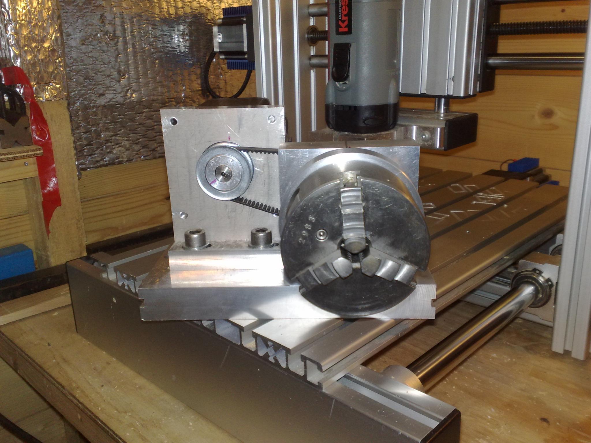

  9. Build is going well and looking at adding a rotary table as a fourth axis. Anyone got experience in converting one from manual to CNC? If so what motor is most likely best to do this with. Looking at either a 4" or 6" diameter table. Any and all input would be seriously appreciated. Also looking at converting to ball-screws for all axis' as well and thinking that 12mm would do my well for that. This is converting one of Marchant Dice's MDL-2-TR to full ball-screw and adding enough Z to allow for a 4th axis to be end mounted (most likely a 4" the more I look with a MT2 arbor mount option).
    It will be mostly used 3d milling, though if the hardened bronze and cast iron gears could take it might do a bit of lathe type work from it. Any suggestions would be great.
    Also has anyone wired up DIYCNC's control board to a Kress spindle? If so or if some one knows would greatly like some insight into that as wiring is something that is not one of my strong suits and willing to admit it.

  10. A bit of an update,
    re posting pic's here on the build and giving a bit more info on what I am up to. Also hope to be able to load a video as well. Got the system 4 on line and it is really making a bit of difference with the reduced wire runs and being able to condense things a bit. Have made a few widgets for setting edges on projects for clamping and proving useful. I am going to be milling some of the cable guides and safety switches out of acrylic and that is going well in the design phase (will post the .dxf files when I have them done). So all and all things are moving forward. Bought a 4th axis and will post pics here.
    Here is the pic's:Click image for larger version.
