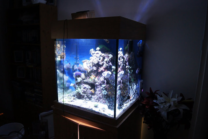

Check out my examples below which show the kind of work I am thinking of doing. This is my NanoLight V3 Project for illuminating Reef Tanks.

End Product
End Product under test

Nice tank, It reminds me my adventure with cichlids few years ago.
