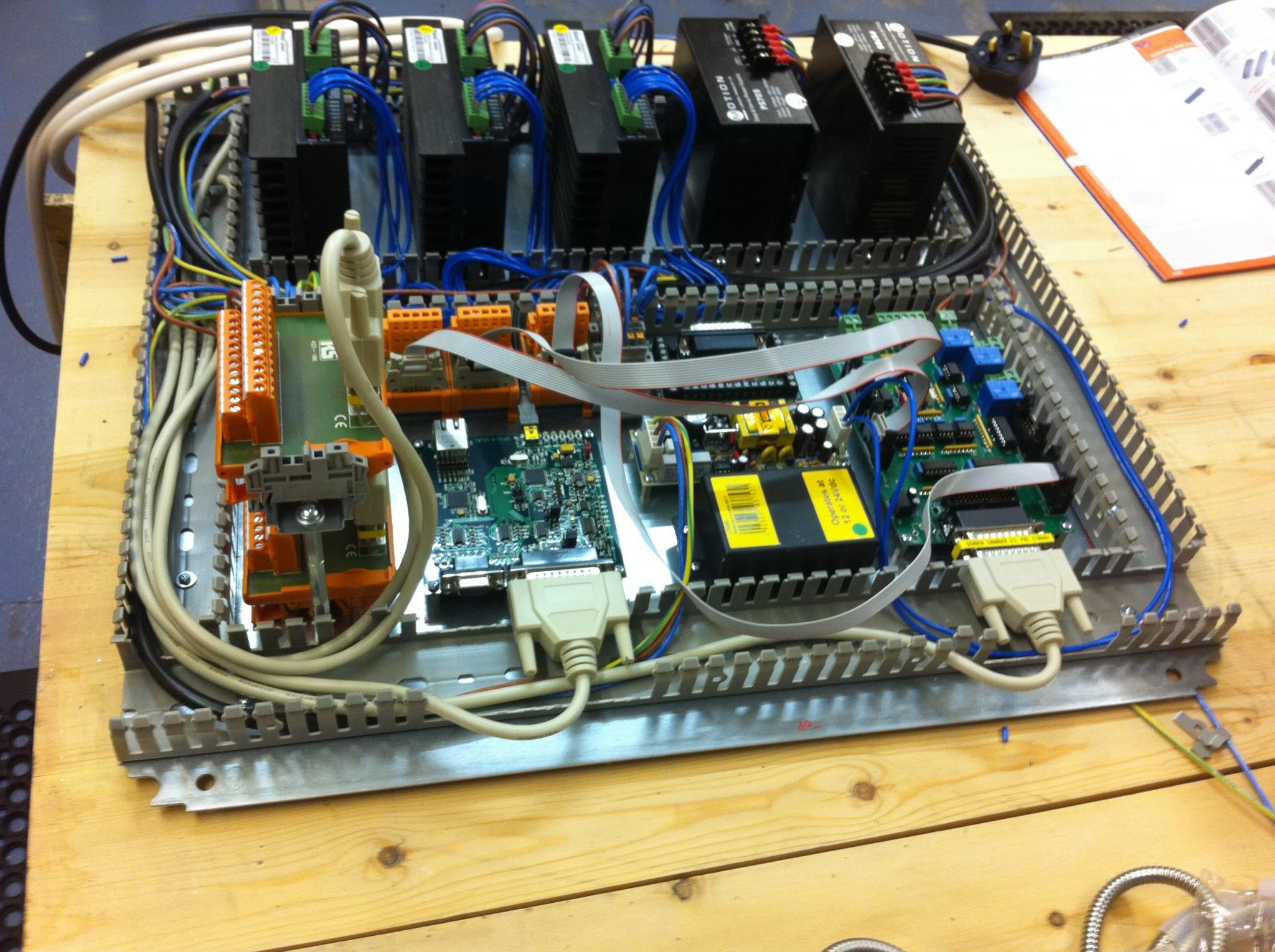

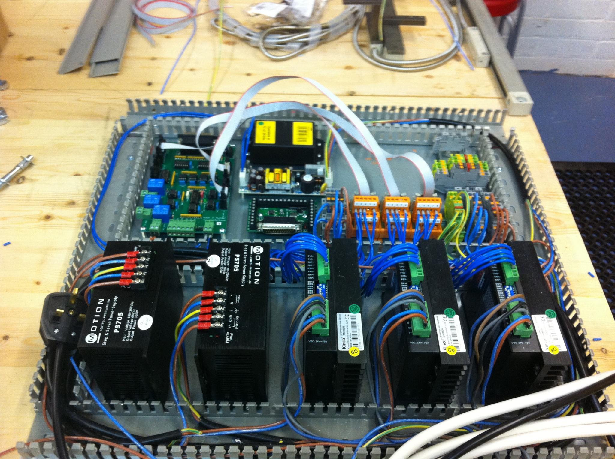

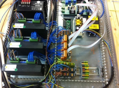

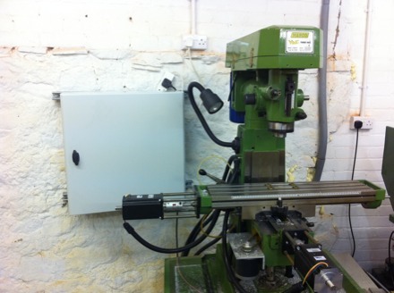

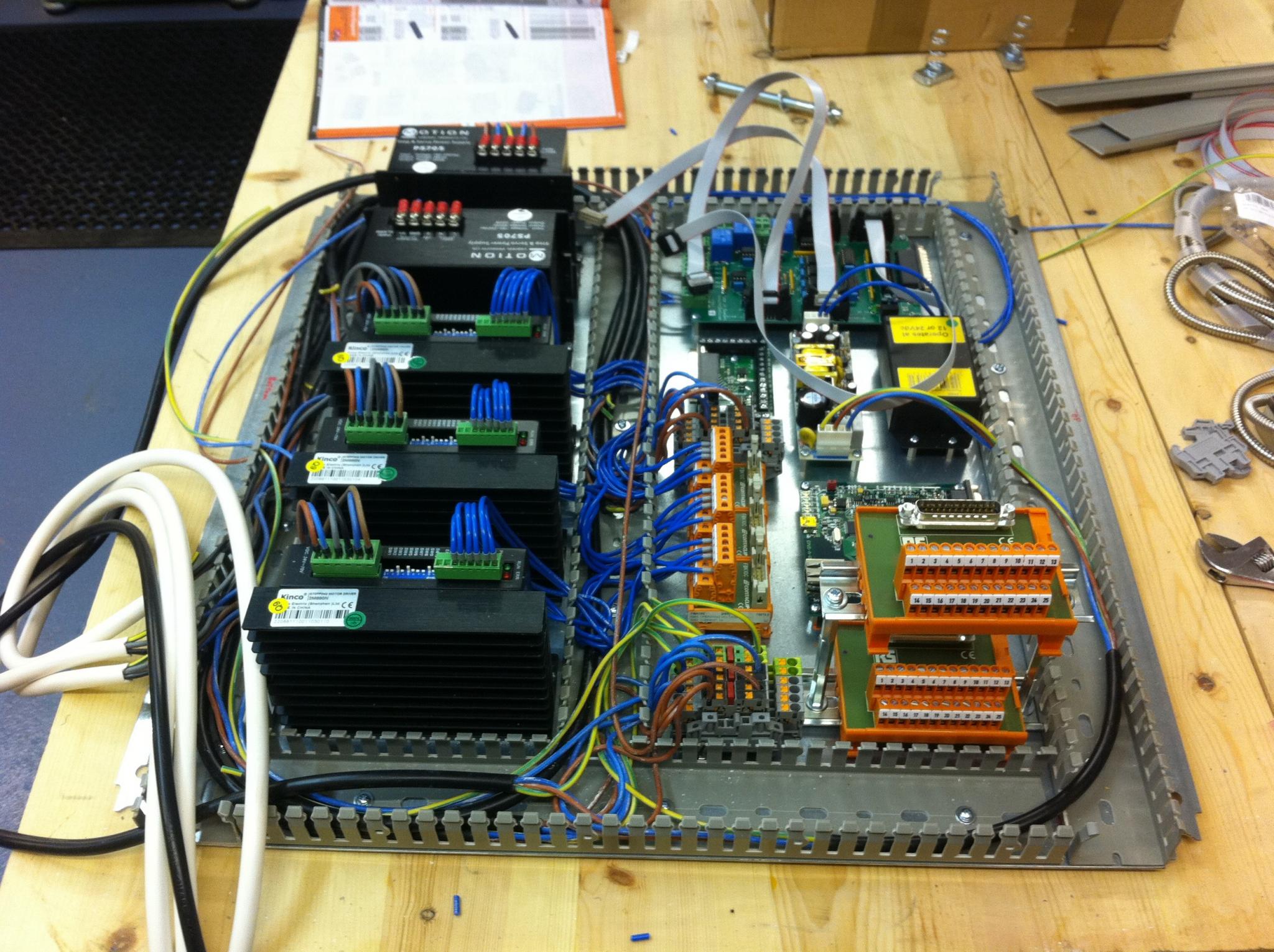

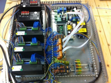

    Just a few more pics of current progress. Hoping to have the controller up and running within the next couple of weeks.
    Ant

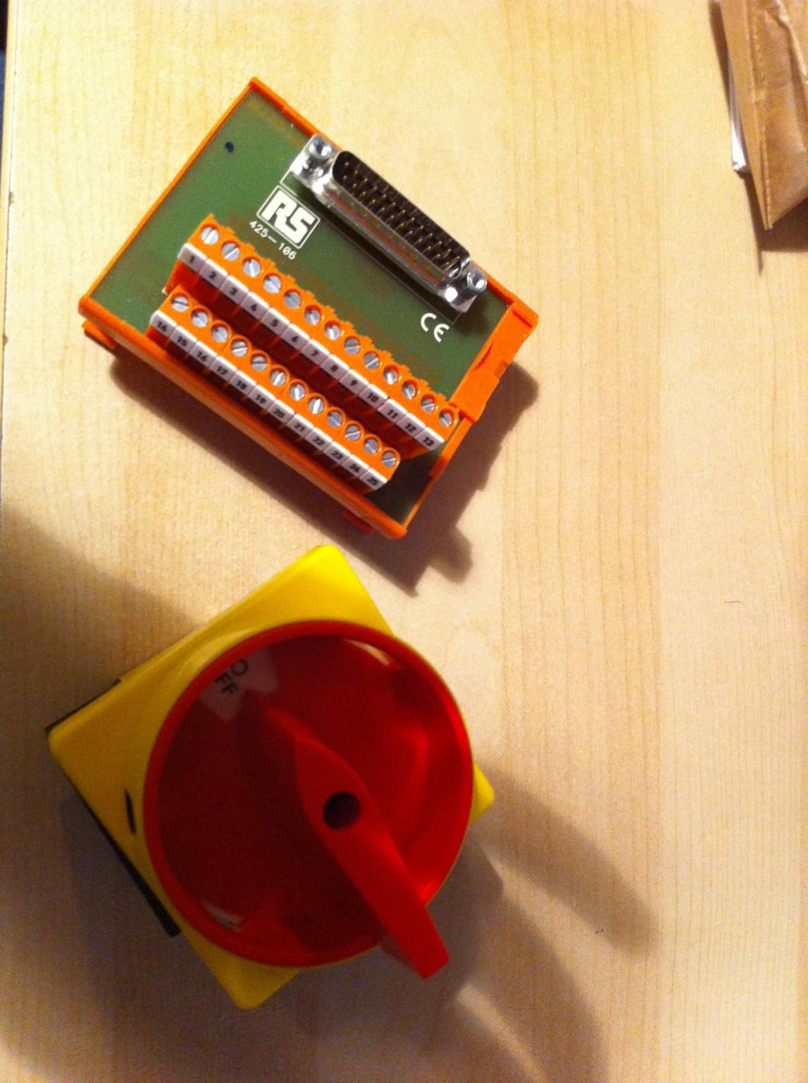

    Another couple of parts. The 25 pin units are pretty good because they allow for wiring and changing pin numbers easily. I have the the same units for the units between the breakout board and the stepper drive units.
    Ant

  8. #18
    One of the pictures wasn't too clear but you can see all the wiring better in this one.
    Ant

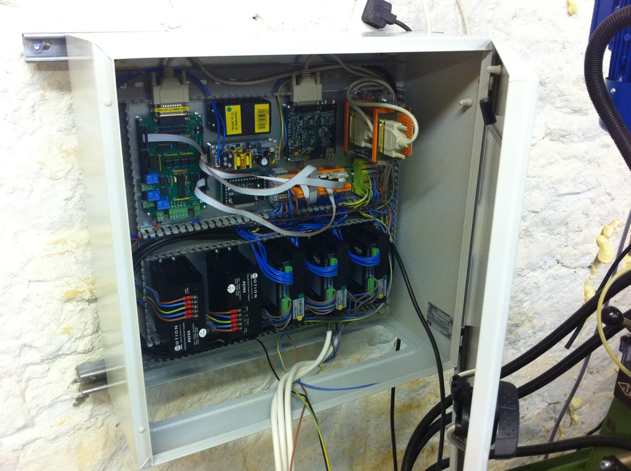

    Done a little more work on the controller today. Hopefully I should have it moving the machine before the end of the week assuming work doesn't take over my life again!
    Ant
