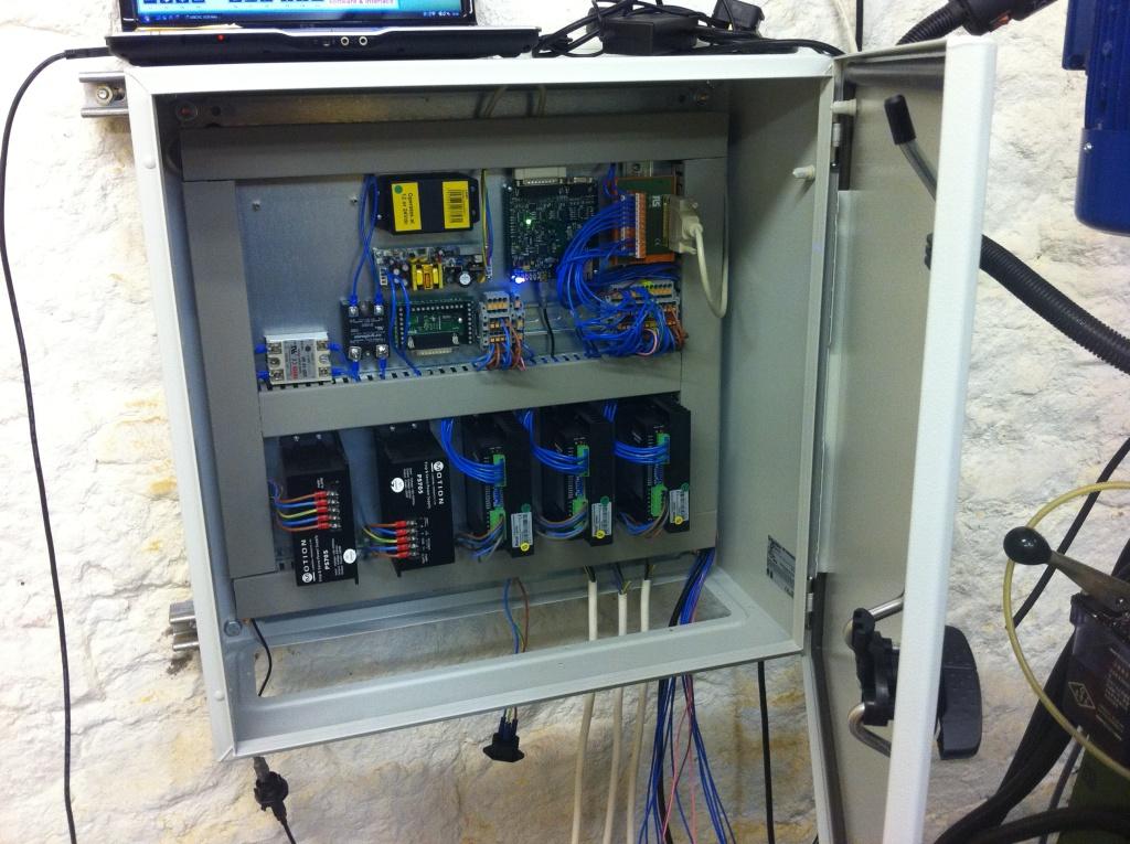

    Done a little more work on the controller today. Hopefully I should have it moving the machine before the end of the week assuming work doesn't take over my life again!

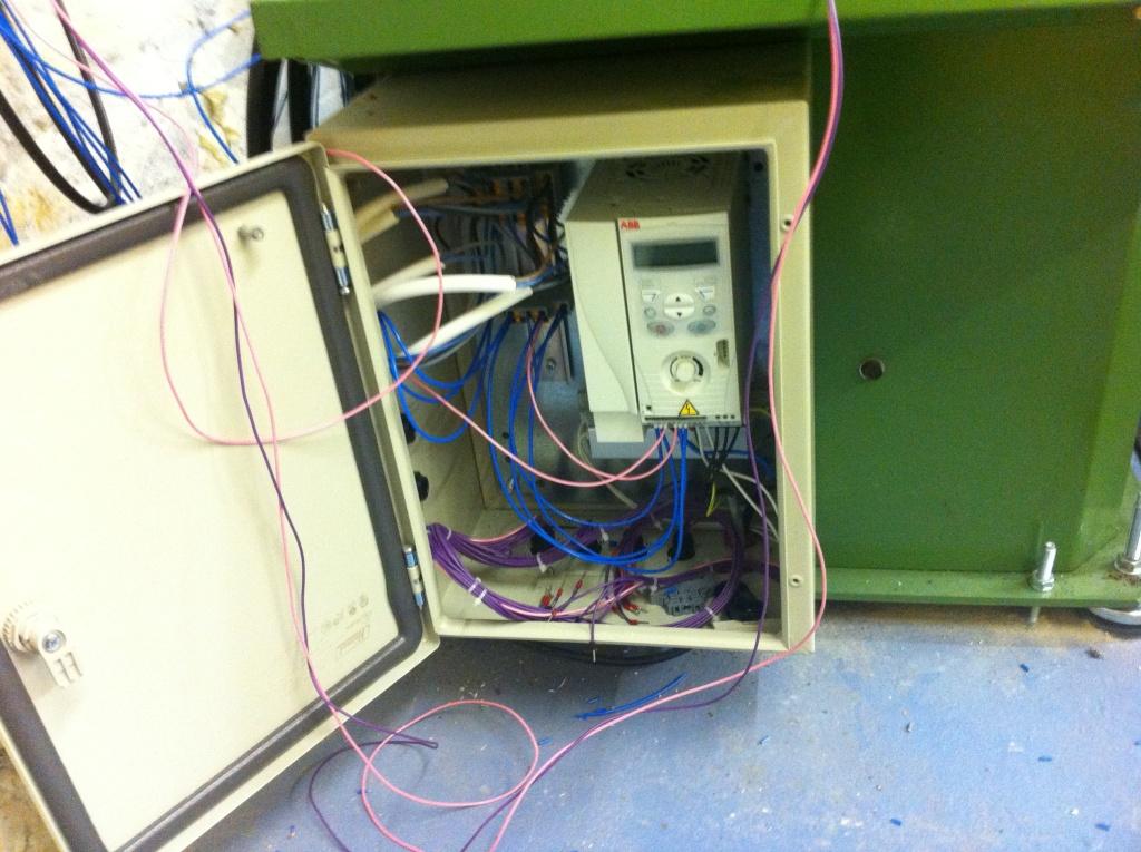

    Happy days.....I got the spindle working via the inverter drive although I had to wire the signal through one of the relays on the breakout board. For some reason the inverter didn't like the signal directly from the CNC Controller.
    If anyone is thinking of putting together a controller the CIB Breakout board and the CPU5 USB CNC Controller card combo seems a really good solution. This is my third controller and by far the best of all of them.
    Still have to wire the stepper Motors, E-Stop and Home switches. (A job for the weekend)
    One question when I shutdown the software / it crashes the spindle starts? Is there anything I can do to stop this as it could become slightly dangerous.

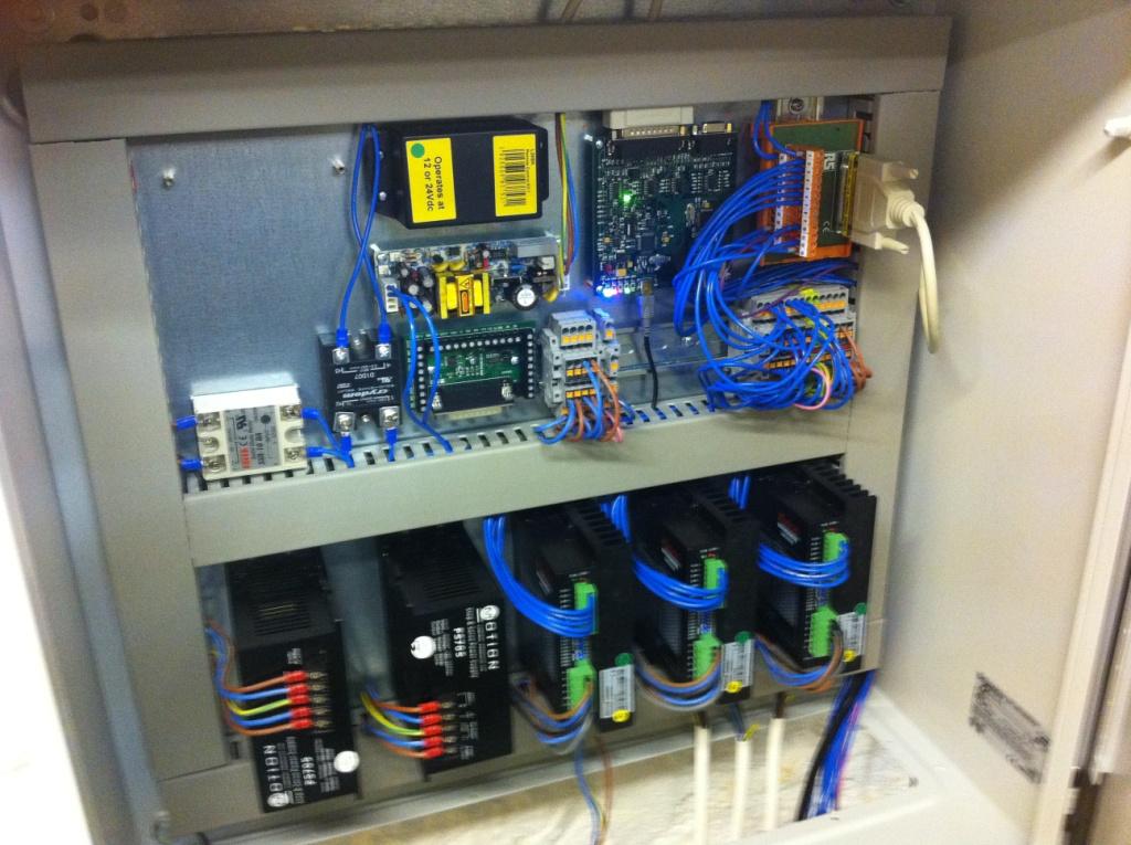

    It's been a while sorting a few other things but back onto the the controller.
    I've done a few updates and removed the breakout board (ready for a different job), I replaced with solid state relays, had a few problems wiring in them in but worked it out after a while. Bert from Eding CNC the manufacturer of the CNC controller card put me in the right direction which was a great help.

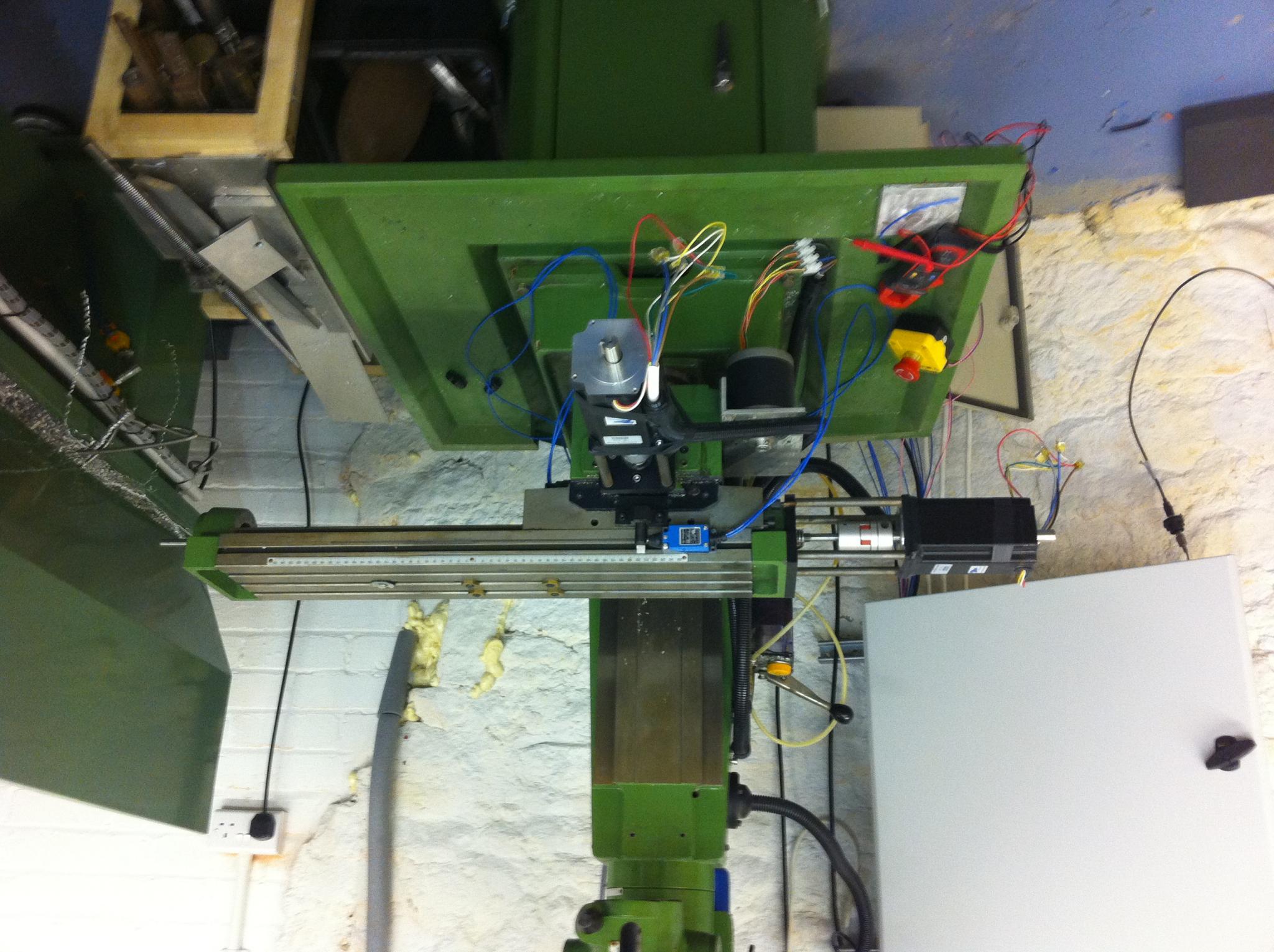

    I've now run my first few parts on the machine.
    It's been a while but here's what I ended up with:-
    > Ended up buying the majority of the kit from Zapp Automation Gary from their was a great help.
    > Was going to use Mach3 software but went with the Eding CNC card. I do have to say it's brilliant.
    > I've now also installed a automatic tool length setter, that again is a great inclusion.
    Anyway posted a few video's on Youtube so you can see how the machine performs.
  5. Antsals, ive got the same turret mill as you and have also been considering cncing this, i also have been using edings USBCNC for over a year now and i agree the software is very good and never misses a beat!
    Have you any pics of the ball nut housings and how you fixed them?

    Did you mention to Gary that you planned to put the motors out on stalks so they couldn't dump their excess heat in to the mill?
    I think the *design* stems from the clock makers guild, all clocks are built on pillars like that. Probably has to have a bit of give to allow the lovejoy coupling to work?
