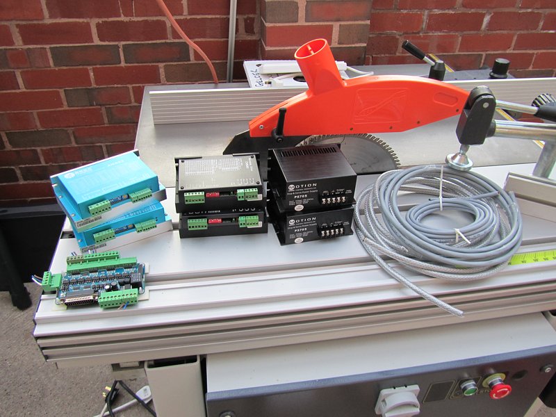

    I'm in the process of upgrading the electronics of my machine and thought it'd be a good idea to post the ongoings here. I'm struggling a little as electronics really aren't my forte but hopefully I can ask questions and get feedback to ensure I'm not making a pigs ear of things.
    The old electronics install was functional but basic and didn't offer the best in terms of maximising what the machine was capable of. The primary goals of the upgrade was more speed through higher volts and generally better quality drivers, secondary goals were to tidy the whole install up and incorporate shielded cabling on the motors.
    Here's a shot of the original install.

    Here's a list of the original parts:
    2x 50v/4.2A Drivers running from 36v Regulated SMPS
    2x 80v/6A Drivers running from 48v Regulated SMPS
    Generic 5axis breakout board
    Kress 1050 Spindle

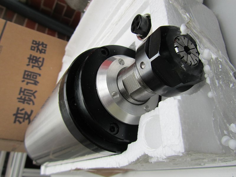

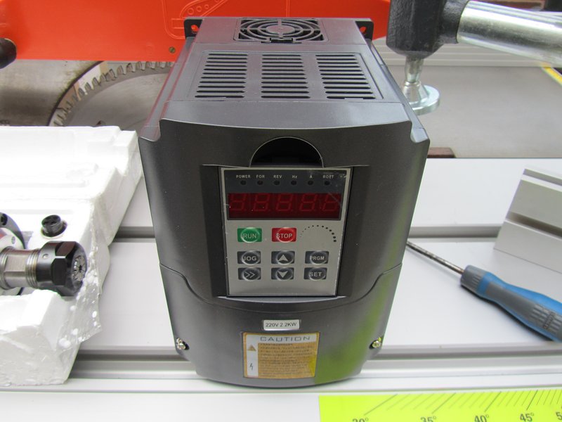

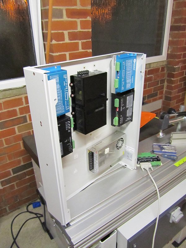

    And after the upgrade:
    4x Leadshine AM882 digital drivers running from a pair of Leadshine SPS705 68v unregulated SMPS
    Generic 5axis breakout board running from 36v Regulated SMPS
    2.2kw watercooler ER20 spindle and VFD
    My *reliable* rapid speeds prior to the upgrade were stuck around 3000mm/min. Afterwards I'm aiming for 5000mm/min which I'll be happy with. Aside from the speed I should have generally better performance throughout the range. The spindle should be a large upgrade over the Kress.
ID:	5487   Click image for larger version.
ID:	5488   Click image for larger version.

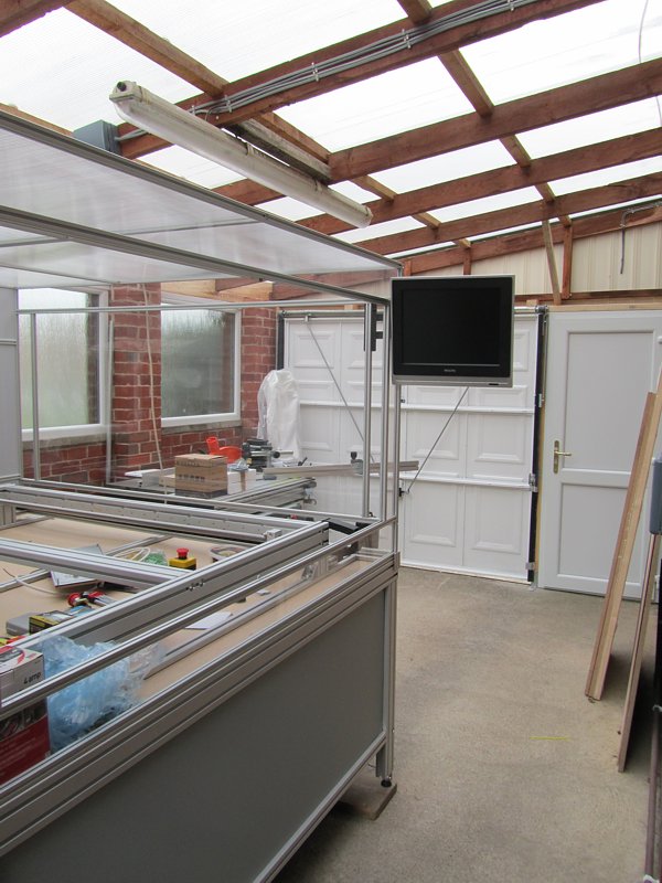

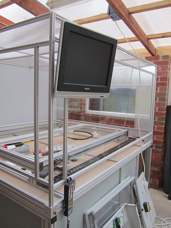

    Aside from the electronics I'm tidying up the machine and integrating the PC into the enclosure too. I bought a cheap LCD swing arm bracket off ebay to mount the monitor and this simple upgrade allows for the screen to be rotated around both sides of the machine depending on where your working from. Also have a convenient Mach hand controller so I'm not faffing around running back and forth between the keyboard and the work.

    Hi Hobbo
    I've not had chance to fire up the spindle to check for noise levels but there's lots of opinion out there that agree's with exactly what you've heard - Quieter running compared to brushed motors used in routers. I doubt there's a whole lot of difference once you start cutting as that tends to drown out any motor noise but some say the higher build quality results in smoother cutting and possibly less noise. I think the main reason for upgrading would be the extra cutting performance rather than any noise reduction benefits.

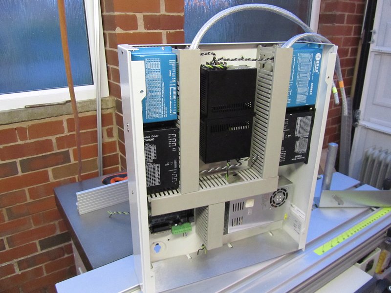

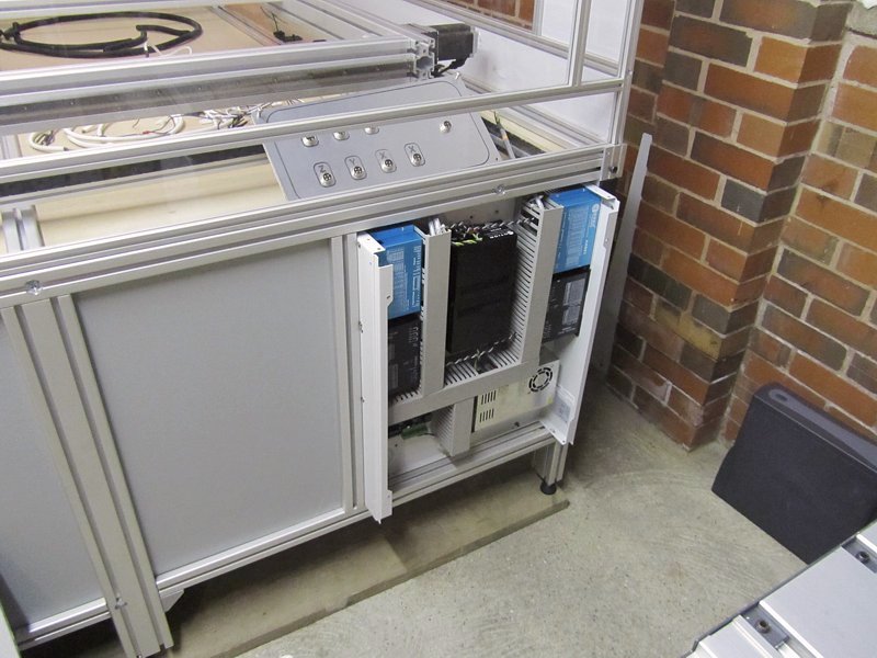

    The electronics are now installed along with some of the wiring. I'm using a couple of AM882 and generic 80v chinese drivers until I can afford another pair of AM882 to complete the line up.

    Question, I'd like to use a relay with e-stop to cut power rather than relying on Mach and the PC.
    Can anyone recommend a suitable relay and is a solidstate relay best for this application?
    Also when wiring for a star ground do you wire the earth cable for the mains cable to this and all other earths from PSU's, cable shields etc. into the star ground? I'm really trying to avoid ground loops but am unsure if this is good or bad practise.
    Quote Originally Posted by Shinobiwan View Post
    Wouldn't use soild state because they can and do fail "ON" as been said by like Ptjw7uk says.
    Easist way is to do it like this pic shows. One cable to the main ground point back to a bus bar type connector that all others take from. There are other ground type connectors but this shows it well.
    Not sure about a solid state relay for a cut off on safety grounds as they can certainly fail ON and you dont want that to happen
    Just my 2p worth.
    Nice set up by the way!
    Peter

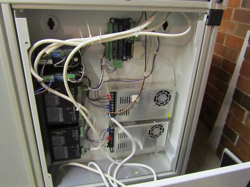

    All wiring within the control box now complete with the exception of the relays. Next up soldering the stepper and home switch cabling in to the connector panel that breaks out on the top side of the machine (you can see the panel in laid up against the bed in the photo). After this its onto rewiring all the top side with shielded cabling and installing home switches.
    Also in the photo if check left next to electronics enclosure there's a panel. This will be removed and a door fitted to house the PC.
