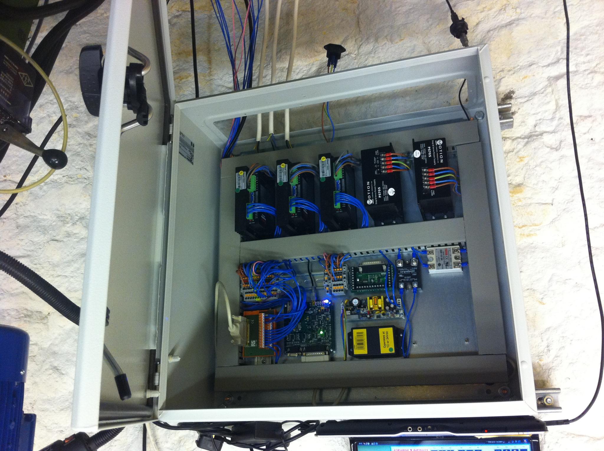

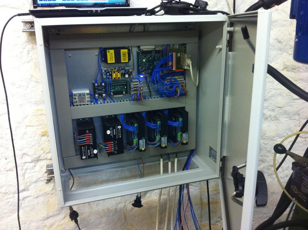

    It's been a while sorting a few other things but back onto the the controller.
    I've done a few updates and removed the breakout board (ready for a different job), I replaced with solid state relays, had a few problems wiring in them in but worked it out after a while. Bert from Eding CNC the manufacturer of the CNC controller card put me in the right direction which was a great help.
    Added a quick video on You tube of the machine axis moving , still need to put the cables in some conduit and also make a few guards for the motors....but getting there at last. Hopefully cutting metal on the machine before christmas.

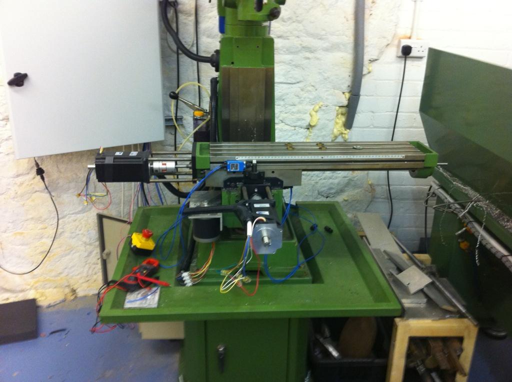

  5. Antsals, ive got the same turret mill as you and have also been considering cncing this, i also have been using edings USBCNC for over a year now and i agree the software is very good and never misses a beat!
    Have you any pics of the ball nut housings and how you fixed them?

    Quote Originally Posted by antsals View Post
    Ended up buying the majority of the kit from Zapp Automation Gary from their was a great help.
    Did you mention to Gary that you planned to put the motors out on stalks so they couldn't dump their excess heat in to the mill?
  7. #27
    I think the *design* stems from the clock makers guild, all clocks are built on pillars like that. Probably has to have a bit of give to allow the lovejoy coupling to work?
