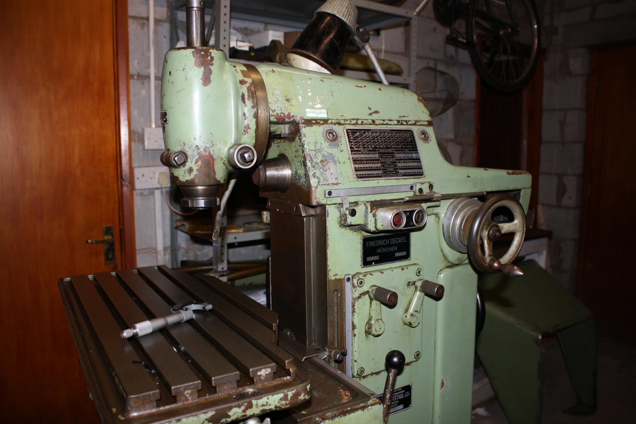

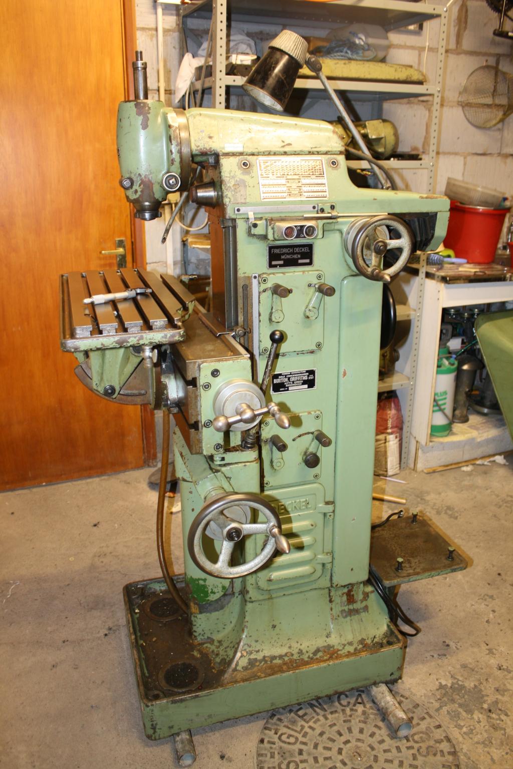

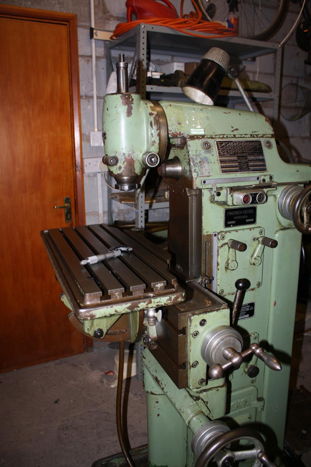

    Not sure who ToT is but this one is a Deckel FP1 probably early fifties vintage and pics attached . If he has one then would love to hear from him.
    Very compact for its capacity as a toolroom mill but nor well suited to CNC conversion , but it was there .
    Good in the hobby workshop due to its size , versatile with 360 deg head , and horizontal spindle , power on X (table traverse) , and Z table rise and fall but sadly no power on Y traverse , About 75 mm of quill movement . Mine came with High speed head attachment (6000 rpm) , dividing head , and slotting head very much as shown here. http://www.lathes.co.uk/deckel/page2.html
    All the power traverses are driven through the gearboxes and via the crosshead, so dont really lend themselves to adding steppers and ball screws.
    These machines are sought after so I didnt want to alter it by adding anything which would fundamentally alter the machine .
    I therefore decided that with the universal table at its lowest level, ( and firmly locked ) I could plant a compound table on top of it and with X and Y stepper motors on that I could give myself the two axis functions (X, Y)
