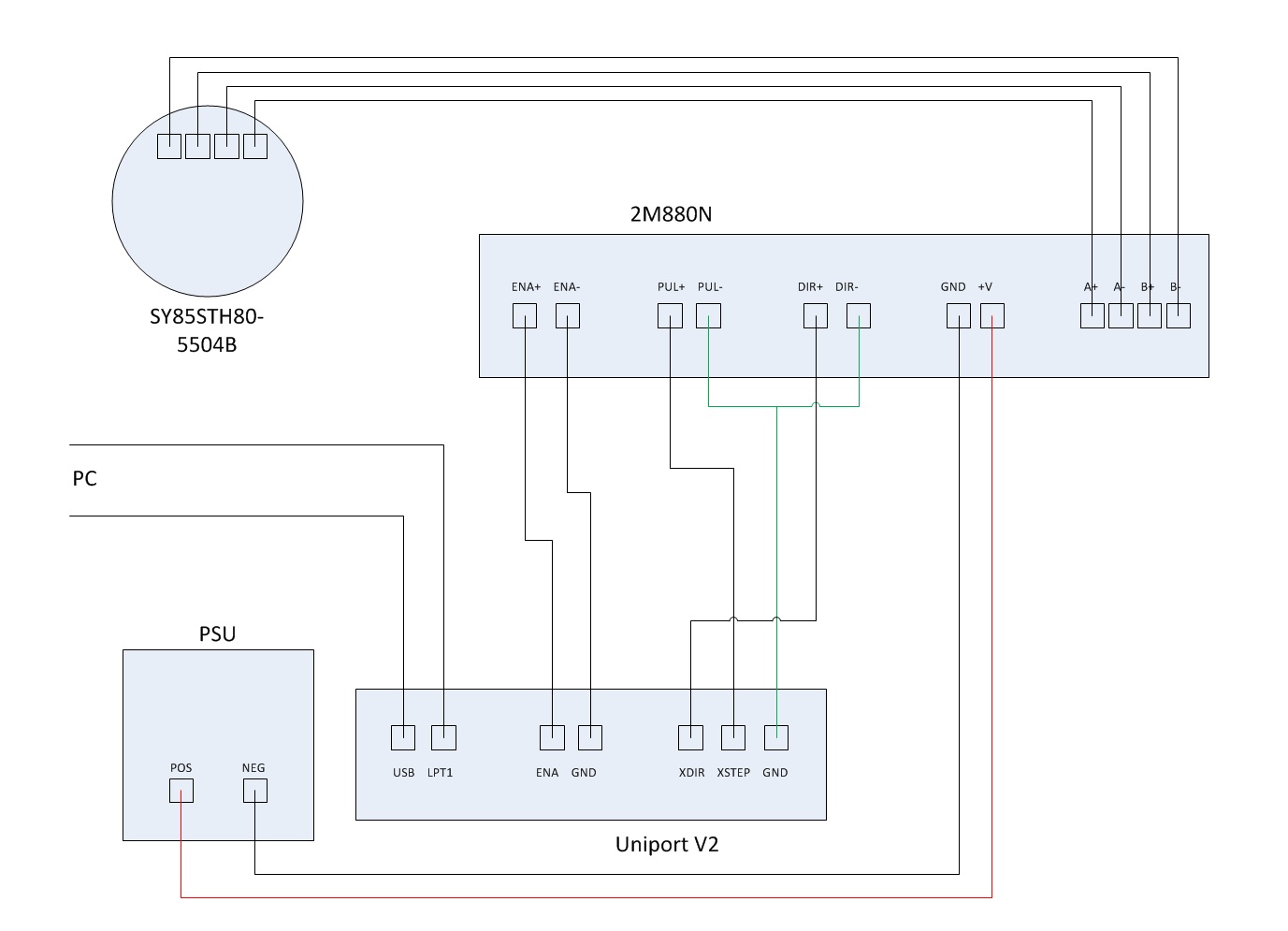

    I have one axis setup at the moment (I have tried it with another stepper/driver/axis and it does the same), if I jog the axis in one direction it makes a slick clonk noise and moves VERY slightly (probably one step) then thats it, jogging in the other direction doesn't get any movement. The stepper does make a slight buzzing.humming noise when trying to jog in each direction.
    The stepper is locked ie I can't turn it by hand.
    I've stripped out mach3 and it's driver and reinstalled in case it was that but it's still the same.
    Hopefully someone can point me in the right direction...pretty please ;)
    BOB - Uniport - http://www.zappautomation.co.uk/uniport-v20-p-510.html
    Drivers - 2M880N - http://www.zappautomation.co.uk/2m88...iver-p-20.html
    Steppers :-
    1 x SY85STH80-5504B - http://www.zappautomation.co.uk/sy85...otor-p-31.html
    2 x SY60STH88-3008BF - http://www.zappautomation.co.uk/sy60...otor-p-24.html
    Images of the wiring can be found in this and the next 2 images

    Hi
    You have no Port or Pin number assigned to your E-Stop
    The video on your website showing the motors running looks fine.
    Andy
    you may have wired the motor phases wrong?
    If you have one phase the wrong way around, it will cancel the other phase out andyou wont get any movement.
    update the wiring to show the colors of the motor wires.

    I actually got an answer within about 2 mins of posting this on the mach3 forums(hood is damn quick 8) ), turns out the pul/dir pins in mach3 where round the wrong way, I did follow the pinouts in the instructions but hey...all working now ;)
    Andy, yep nothing in the estop yet, it's set low so working as normally open while I get the bugs out. proper estop on the way for when it gets all plumbed in ;)
