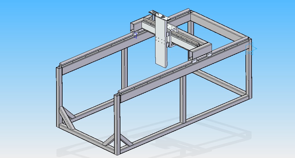

    Hi guys, below are some images and renders of my first proposed CNC machine. I intend to do a small amount of aluminium and wax routing, but mostly I intend to use this to aid in the manufacture of speaker cabinets and PCB milling.
    I've just posted an RFQ over in the other forum asking for quotations on getting some of the parts made up.
    Cutting area is 400mm x 400mm and the parts I intend to use include:
    Ballscrews all around
    Kress 1050-1 FME
    Valuframe extrusion
    Gecko 540 stepper driver
    For the stepper motors i'm not sure, but I was looking at these: http://cgi.ebay.co.uk/3-Stepper-Moto...7#ht_535wt_911. If I understand correctly, even though the motors require 4.2A and the gecko only provides 3.5A, this would mean that the motors just run at reduced torque, and wouldn't damage them, or the controller. Please correct me if i'm wrong.
    The only thing I don't like about the design is how far the Y axis stepper motor sticks out. I was originally looking at setting the motor in the upright support and using a timing belt/pulley combo, but i'm not sure i'm willing to deal with the extra cost and potential increased backlash for the sake of aesthetics.

    Looks good but I am sure you will regret using unsupported rails. Changing to supported rails will give a much stronger and more accurate machine.
    Unsupported will be fine as long as you make them thicker. I would suggest turning the Y frame around 180 degrease as well to centre the weight more and you could then shorten the bed/ rails. You could always mount the Y motor around the back and use a small belt 1:1 to power it as well to stop it sticking out?
    Oh dear. Suggest you redesign it a bit and do everything possible to get rid of the overhangs. You really want the shortest possible connection between the router bit and the workpiece to minimise flex. Do you really need that much travel on the Z?
    Flex is easy to overcome, you simply reduce the cut depth/feed. If you want to cut deep and hard fix it now before it's all too late :naughty:

    I agree unsupported rail is a bad plan, especially on the X-axis as the end fixity is poor. Even 30mm unsupported rail will flex more than 12mm supported. Granted the load ratings of the bearings on the 30mm rail would be higher but they're plenty more than required anyway. I would use 16mm, or more if you can afford it. 25mm supported rails are good as they have an additional row of balls ... though on this size of machine you don't need that size. Have you looked on eBay for them? They're cheap from linearmotionbearings2008.
    You might want to bolt the Y axis plate to the back of the gantry, not the front, as that will get the centre of mass closer to being half way between the pairs of X-axis bearings.
    There is a lot of overhang, as Robin said do you really need that much Z travel? If so you're best to eliminate the gantry sides altogether, like I did here:

    Plate is also the worst profile for the gantry sides since it bends easily in the direction parallel to the Y-axis, however you've compensated for that by having a plate parallel to the Y axis, so the only thing it will lack is torsional stiffness. You could use something lighter if you changed the cross section - maybe extrusion? That's expensive though. Steel box section is cheap and the weight isn't really an issue since the gantry is fixed. Just make it as strong as you can.
    Also if you want the machine to be fast use timing belts on the stepper motors/screws to get the motor operating in the right region. Since you're machine is quite light you will almost certainly want the pulley on the stepper motor to be bigger than on the screw. What pitch ballscrews are you using, probably 5mm? I have not noticed increased backlash from using timing belts/pulleys. They do stretch very slightly, but I don't think that's a big issue.

    Thanks for the input guys, I really appreciate it. I hadn't seen the seller linearmotionbearings before.. boy is he cheap! I'm really liking the look of the machine you posted Jonathan but wouldn't I need two ballscrews and two steppers on the X axis?. looks like I could get a larger machine for the same budget, using the supported rails that everyone seems to be suggesting from linearmotionbearings. The rails I put in the original plan were 16mm so I guess I overestimated their strength.

    Hi guys, this is my latest design. It is based off of Jonathan's design and uses:
    15mm plate
    20mm supported rails
    twin x axis ballscrew
    Aluminium extrusion for x axis rail support and Y axis.
    Will be welded to an aluminium frame when complete
    Let me know if you guys think this is an improvement. The Z axis isn't completely finished yet..

    Y-axis: You need to have the 4 plates that make up the 'box' round the linear bearings configured such that the plates with the bearings on can be adjusted to get the bearings precisely parallel. Look how I did it ... just don't copy my mistake - making two of the plates 10mm too short! At the moment it relies on the two plates in the YZ plane being machined very very accurately which just isn't going to happen.
    X-axis: End supports for the ballscrews look a bit bendy? Remember that all the cutting force in the X direction will be resisted by those plates, so they want to be strong to stop the tool deflecting much. That's why I made mine the odd looking shape out of bar. The easiest solution I can think of is to replace them with box section then put a smaller plate/disc on that to mount the bearing. Have the holes slotted on both so you can align the ballscrews.
    If you rotate the ballnuts by 90° you can get the ballscrews slightly closer to the tool...probably not significant.
    The way your Y-axis box section is mounted to the X-axis is a bit bendy as the vertical plates only have a line contact with the X-axis bearings. That's why I used box section...
    You could get the gantry even further down? Debatable if it's worthwhile.
    Other than that looks good (but obviously I'm going to say that as you copied mine )
