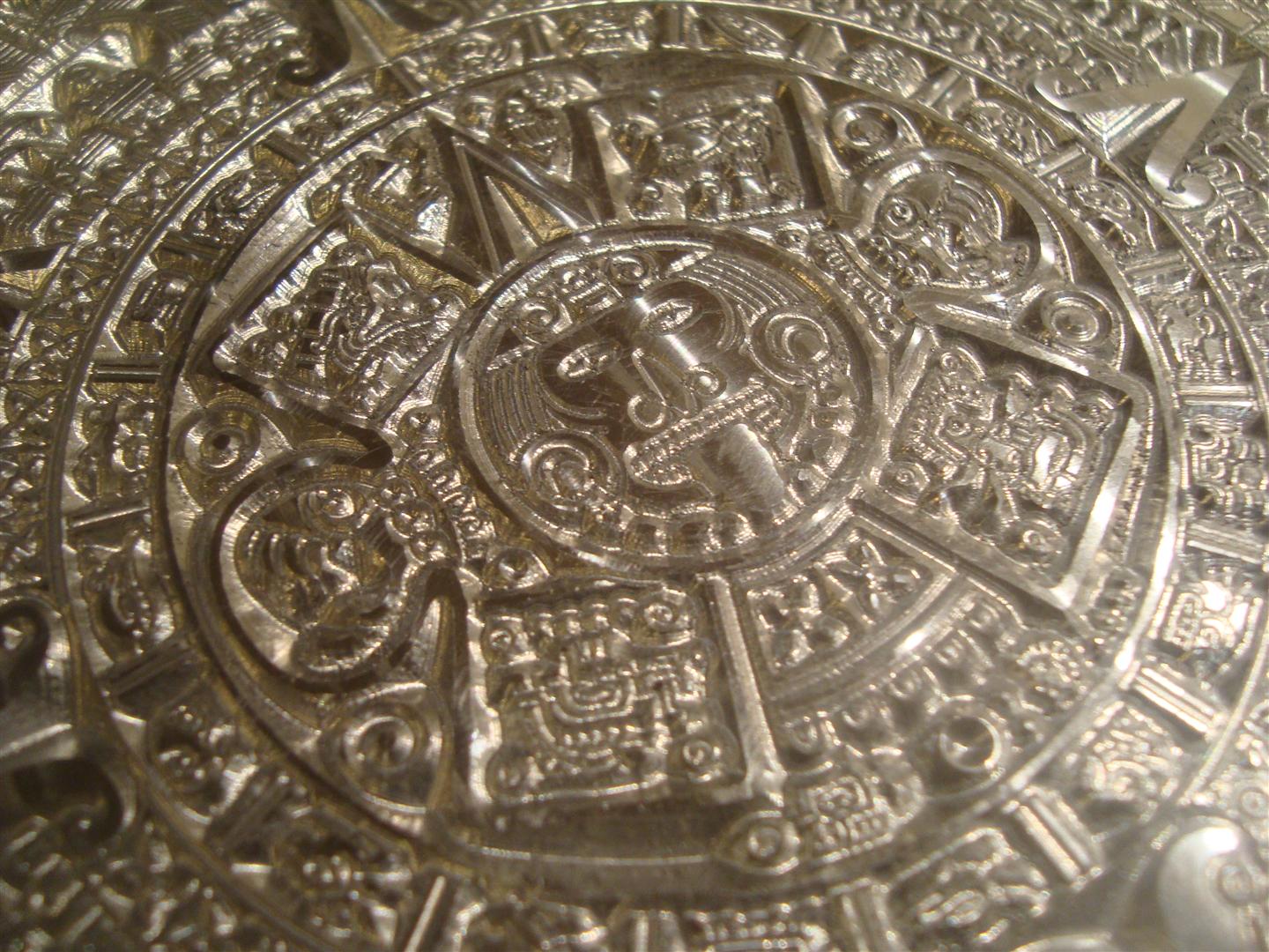

    Re v carve, I bought a bit but it has a 1mm tip. Does anybody know where I can get one with a point? Need two, a small one (1/8 shank) and a 1/4" shank, say 1/2" diameter, 60 degree ideally? Some of the fonts have very sleek sharp strokes which don't show up with a blunt ended bit. I must find the spare Kress as the largest proxon collet is 6mm. How annoying is that! Oh, my 1/4" taper reamer is put away too!

    Spot drills often go to a point and they're available in lots of sizes, so you can do intricate carving with them. I did this one with a 6mm 90 degree spot drill:
Name:	DSC08568 (Large).JPG
ID:	5130Click image for larger version.

    Quote Originally Posted by chip View Post
    jon that looks stunning .mayan calender?what size is it
    Thanks... yes it's an Aztec/Mayan calender and I'm not sure which year! It's 150mm diameter, about 11mm thick. Now I bet you want to cut aluminium on your router again

    Nice work Jonathan. What did you generate the code with?
    Ian
    Vectric V-carve, except it wasn't me. Jazz kindly gave me the code which saved a lot of time! :tup:

    It was actually done im Artcam pro not vectric V-carve.! If anyone wants the code there welcome to it but it's a 17mb file and over 1 million lines of code.
    PM me with email and I'll send.
    Ian, (Web Goblin)
    The guy who gave me these dxf's(Carve0ne on cnczone) was cutting quite large disc's in mdf and oak. I wanted to cut 150mm in Ali so the dxf's had to be scale down which caused quite a bit of editing and tweaking. So if you paln on doing small disc's then depending on the dxf you've found, (which I guess will have originated where mine came from or could even be my dxf's if 150mm because I did make them available along with the code) may have to do the same.?
