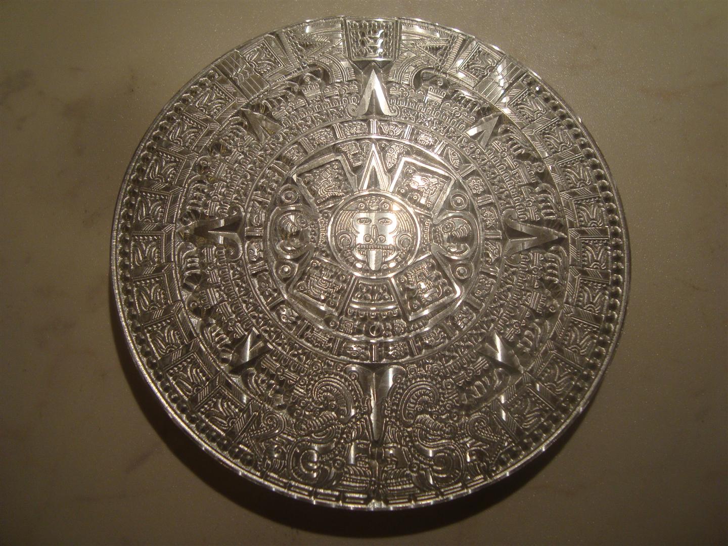

    Spot drills often go to a point and they're available in lots of sizes, so you can do intricate carving with them. I did this one with a 6mm 90 degree spot drill:
Name:	DSC08568 (Large).JPG
ID:	5130Click image for larger version.
Name:	DSC08571 (Large).JPG
    Quote Originally Posted by chip View Post
    jon that looks stunning .mayan calender?what size is it
    Thanks... yes it's an Aztec/Mayan calender and I'm not sure which year! It's 150mm diameter, about 11mm thick. Now I bet you want to cut aluminium on your router again

    Oooo, thats nice. I tried a small dremmel thing but it snapped after ten minutes :-( My current solution is just to make the font's bigger until I can find one.

    Nice work Jonathan. What did you generate the code with?
    Ian
    Vectric V-carve, except it wasn't me. Jazz kindly gave me the code which saved a lot of time! :tup:

    Might have to speak nicely to Jazz. I would like to give that a go.
    Youve got plenty of time to find the spare Kress. The guy who carved the calendar couldnt find his spare chisel to finish it.
    Ian
    Also interested in the details, how did you create the relief?
