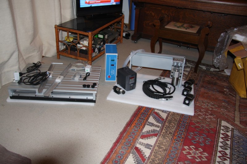

  1. Although I'd hoped to make my first CNC router myself, moving house got in the way. Now I'm settled in my new home (Tasmania), I decided to buy a small eBay unit to get started.
    This is the one I got - or will get once it's paid for and sent :tup:
    There was some discussion on another forum about the quality of these units. The opinion seems to be that the electronics and software are crap but the mechanical components are worth the money. I've got a Gecko G540 spare and a copy of Mach 3 so I can replace as required.
    I'm sure there are people here who have considered the eBay units so I'll update once I receive the unit and play with it a bit.

  2. Picked up router and so far have only unpacked it.
    Seems pretty well made and I consider it value for money.
    FYI, here's a link to the eBay item. It's actually quite a bit cheaper (shipping) than I paid for it a week ago.

    yeeehaaaawww!!! nice one, you should be cutting things to bits in no time :)
    the first time you press go on a bit of g-code is a quite a moment... i half exspected mine to jump up n cut my leg off :lol:
    good luck dude :)
    Geoff,
    That's an awesome bit of kit even if the box is rubbish.
    I think you would be struggling to build one for that price given it comes with high speed spindle and VFD ?
    I have a Teckno-Isel router but it's only 300 x 300 working area and this looks to fit the bill ideally.
    I'd be interested to see how accurate this is when you have it running.

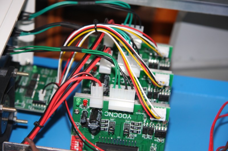

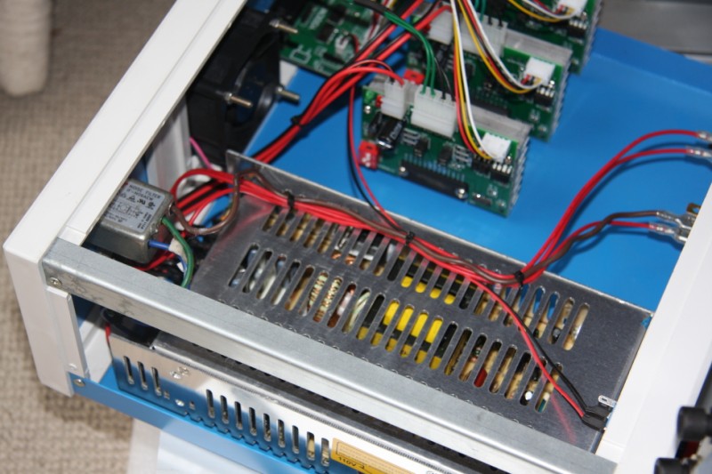

    The controller is pretty basic - see photos . Fortunately I have a spare Gecko G540 controller and a 48v power supply so an upgrade is likely. I just need to find out some info on the steppers, the only marking is 57BYGH636

  6. Never one to rush things...
    Finally have a new place to live and the mandatory shed so got the CNC router assembled.
    Sorting out Mach 3 and hope to test run it tomorrow. If all is well, it moves from the kitchen table t the shed for some cutting!
  7. Well there were a few problems getting it to go. After much swearing and changing of configs in Mach 3, it turns out that it was a parallel port issue.
    The controller interface requires 5 volts which it expects to get from the parallel port but my PC didn't provide the correct voltage/current.
    Connected a separate 5 volt power supply to the interface and all was well.
    There still tuning of the motors to do but that will have to wait, off on a sailing weekend tomorrow!
    Geoff
