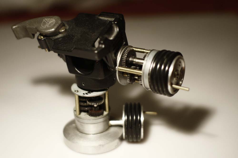

    this is a pan tilt head i made a few of years ago for stopmotion animation so hand cranking them was the way to go (motion blur has to be done in post production with stopmotion)
    the gearboxes are 3000/1 i think i paid £18 each for them at maplin

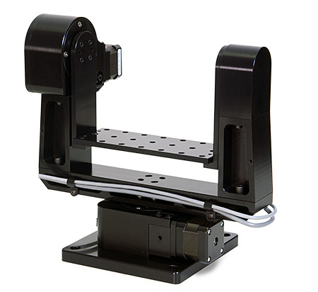

    Also I'm looking for ways of making a pan and tilt head for the second part of the project. I think a gimbal type of mount may do the job.
    or something more like this:
