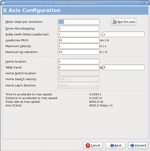

    24 teeth, 5mm pitch 1 rev = 24 x5 = 120mm per rev
    can't be anything else.
    120mm is the circumference at the pitch diameter so it has everything to do with the circumference.

    Jesus H Christ this is like pulling teeth, we have all the details including what you had for dinner but not what was asked.
    HOW MANY STEPS PER ARE YOU SET TO ?
    Using EMC2, not mach3 so you don't set the steps per directly... you enter motor steps per rev (so 200 is correct), microsepping (so 16 in this case), pulley ratio (4.5 as discussed) and leadscrew pitch (120mm).
    It looks like at the moment you have the leadscrew pitch set to 100mm not 120mm .... so either change that or put the ratio to 5.4 and it'll be fine.

    Jonathan i tried 5.4 already and it was close but not quite. I will try again tomorrow with the DTI, i think sometimes we can only let the math get us most of the way there then rest is probably a bit of trial and error. i will set out a drawing to draw out markers, I have about 1300 cutting distance which is a large distance to loose on.

    The difference between 5.35 and 5.4 is less than 1% ... I wouldn't be too surprised if there's that much error in the belt, particularly as it's quite long. I would definately try the DTI, or even attach digital calliper as that gets you 5 significant figures (unless your DTI is digital too). Digital calliper is not perfectly accurate, it will say the tolerances in the instructions. Either way it's better than a ruler which could account for the 1% error.

  6. #26
    Here is an example (not my config by the way)

  7. #27
    my config is set up in metric, it is very straight forward to use
