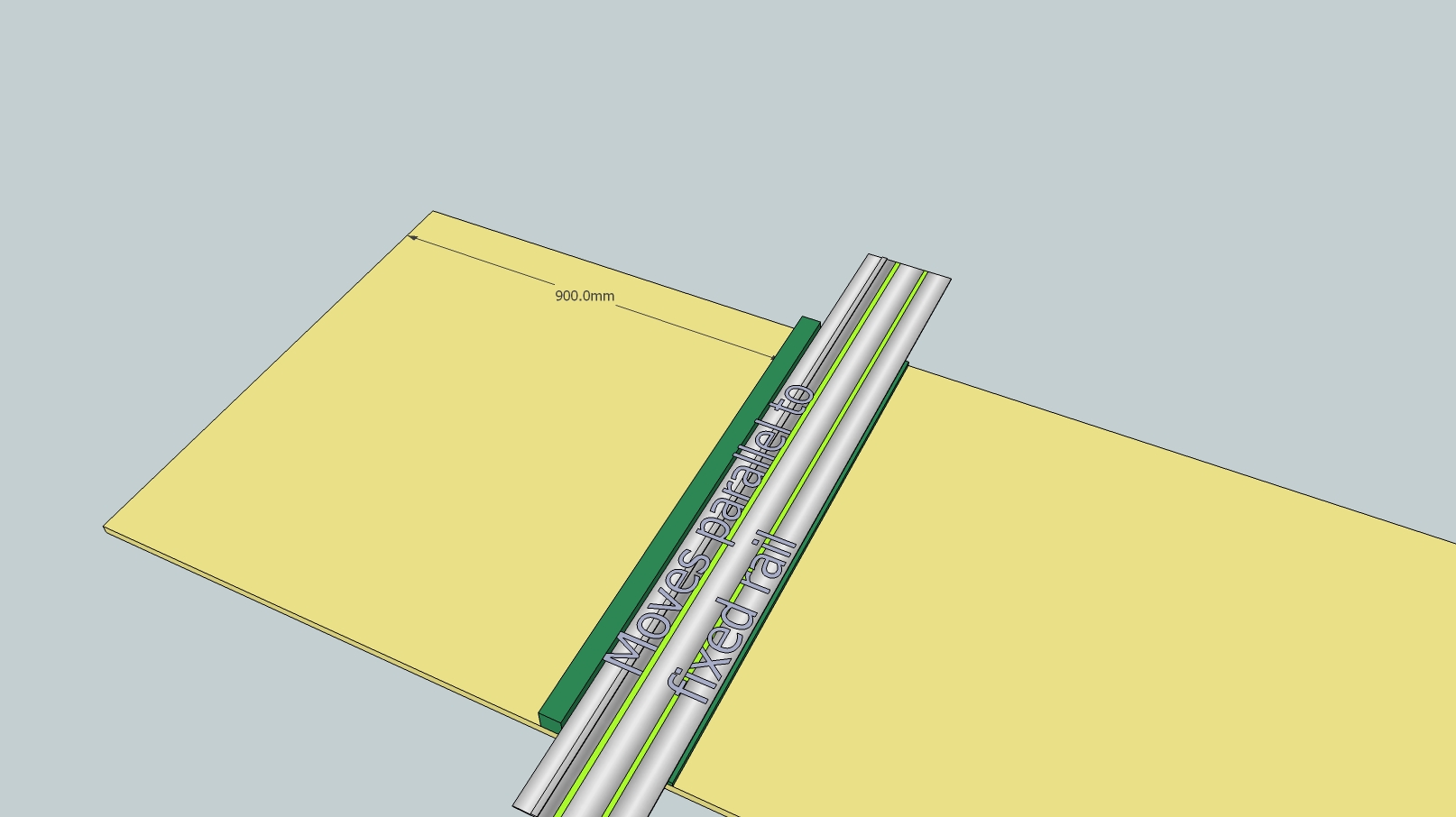

    I make kitchens in a very non-cnc kind of way, and I want to use CNC techniques on a simple woodworking machine. Unfortunately, although I have a reasonable grasp of how CNC works, and I understand (mostly) what the various parts are, I have no practical experience at all and so I am here hoping someone can help me or at least point me in the right direction.

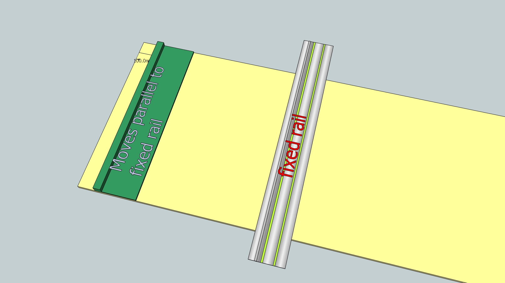

    Let me tell you what I want to do- I want to be able to move a fence (in the woodworking sense) of about a metre long, over the surface of a table so that the fence remains parallel to a fixed rail. Illustrations below

    I would like to be able to position the fence to an accuracy of 0.1mm, if at all possible. A total travel of about 800mm would be enough. Once in position I need it to be able to resist the force needed to push a piece of board material against it so that it can be cut by a saw moving along the fixed rail (which I will do by hand).
    I would also like to be able to make a trial cut, measure the resulting piece, then tell the computer (I have a machine that runs XP at the workshop) what the length of the piece is, then tell the computer what length piece I require, and have it move the fence accordingly, so I will need some software too.

    Thanks for that, but the cutting aspect is absolutely no problem at all. It's positioning the movable fence (green element in the sketches) that I need to get sorted out. I'm happy to keep it simple, as long as it is effective. The picture (if that's what it is) in your reply doesn't work, BTW.
    You don't say how long the fence is but you will need either two support rails for it and one feedscrew, ballscrew actually if you want to keep to 0.1mm accuracy, or better still two ballscrews linked by timing belt to stop the fence crabbing.
    Add to this a stepper motor, driver and power supply.
    Your XP machine could run a trial version of Mach3 in that you only need MDI input and do not need to run any lines of code. You could even use a custom screen.

    The fence will indeed need to be around 1 metre,( sorry, should have said). The 0.1mm accuracy would, while not essential, certainly be worth paying extra for, 0.5mm would be disappointing and I doubt it would be worthwhile building it.
