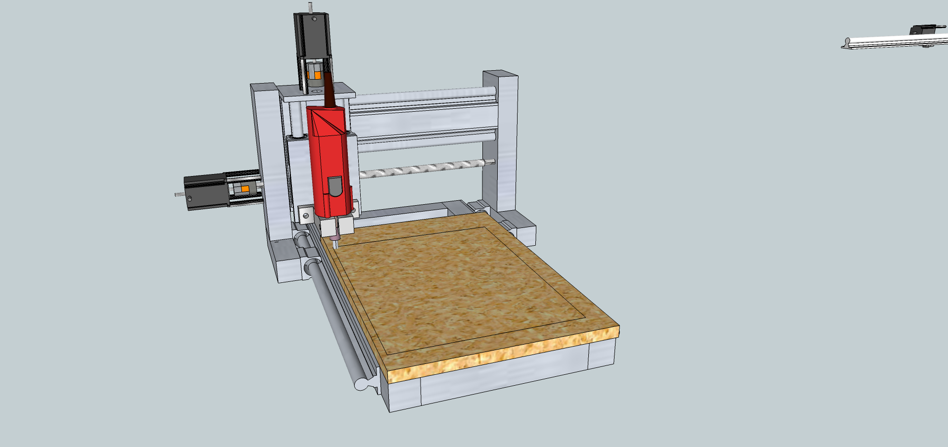

    what do you guys think so far? the cutting are from the outside of the 10mm bit is 420x290
    so just under A3. this is with 20mm clearance on each side of of gantry when moving in all directions.
    so the actual cutting are is 40mm bigger both ways.
    I need to re-think my Z axis though, it's too big and won't give the spindle enough depth.
    I'll be limited to the thickness of the sheet not be the length of the supported bar.

    The way you've orientated the X-axis linear bearings will make them difficult to align parallel - you would have to cut the frame they attach to extremely accurately or have some adjustment. If you rotate them by 90° then it's easy to align them as you can fix down one and use it to get the other parallel.
    Having the Y-axis ballscrew close to the bed is a good plan as that reduces the overhang... which will reduce deflection parallel to the Y axis. Similarly to the X-axis you've not got a way to adjust the spacing in the Z direction of the Y axis bearings. That orientation is good .. you just need to have the plates in the YZ plane bolt to/overlap the plates in the XY plane. Look at how I did it on my machine if that's not clear.
    Where's the X-axis ballscrew(s)?
    Putting the rails on the moving part of the Z-axis is stronger than having the bearing blocks moving when it's at the upper limit. Be careful with making the Z-axis too long. It will make the machine much less rigid. I had that problem (400mm Z axis!) so I ended up eliminating the gantry sides:
    http://www.mycncuk.com/forums/showth...ding.../page11
    (only need to look at the last few pages...)
    Mounting the stepper motors on posts has poor torsional stiffness. A 'solid' mount would be better.

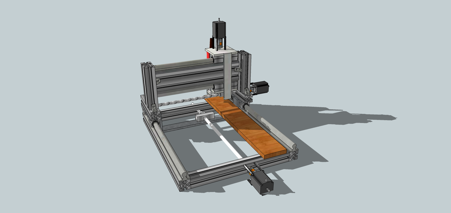

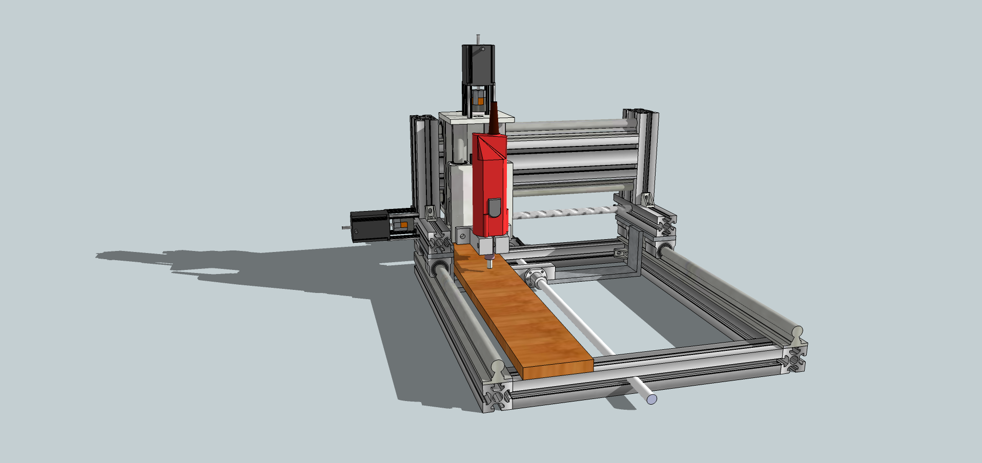

    How's this lads?

    I'm guessing this thread silence means you can't see anything wrong with my drawing? :)
